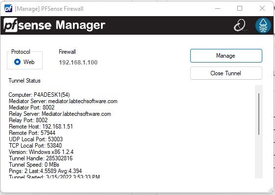

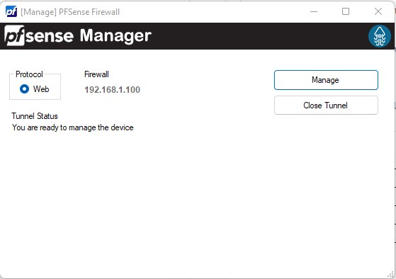

Launch the Redirection control

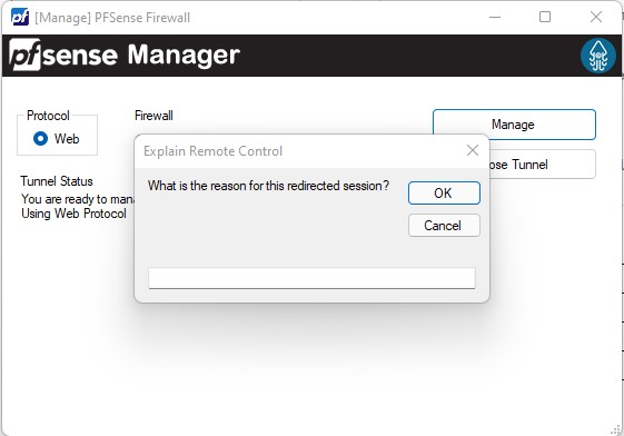

Select to manage Firewall and give some type of consent when prompted

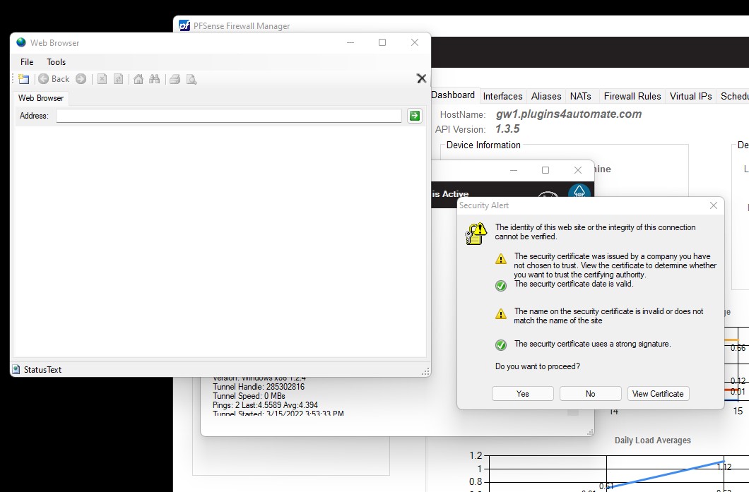

Give it a few seconds to connect, accept the SSL error notice.

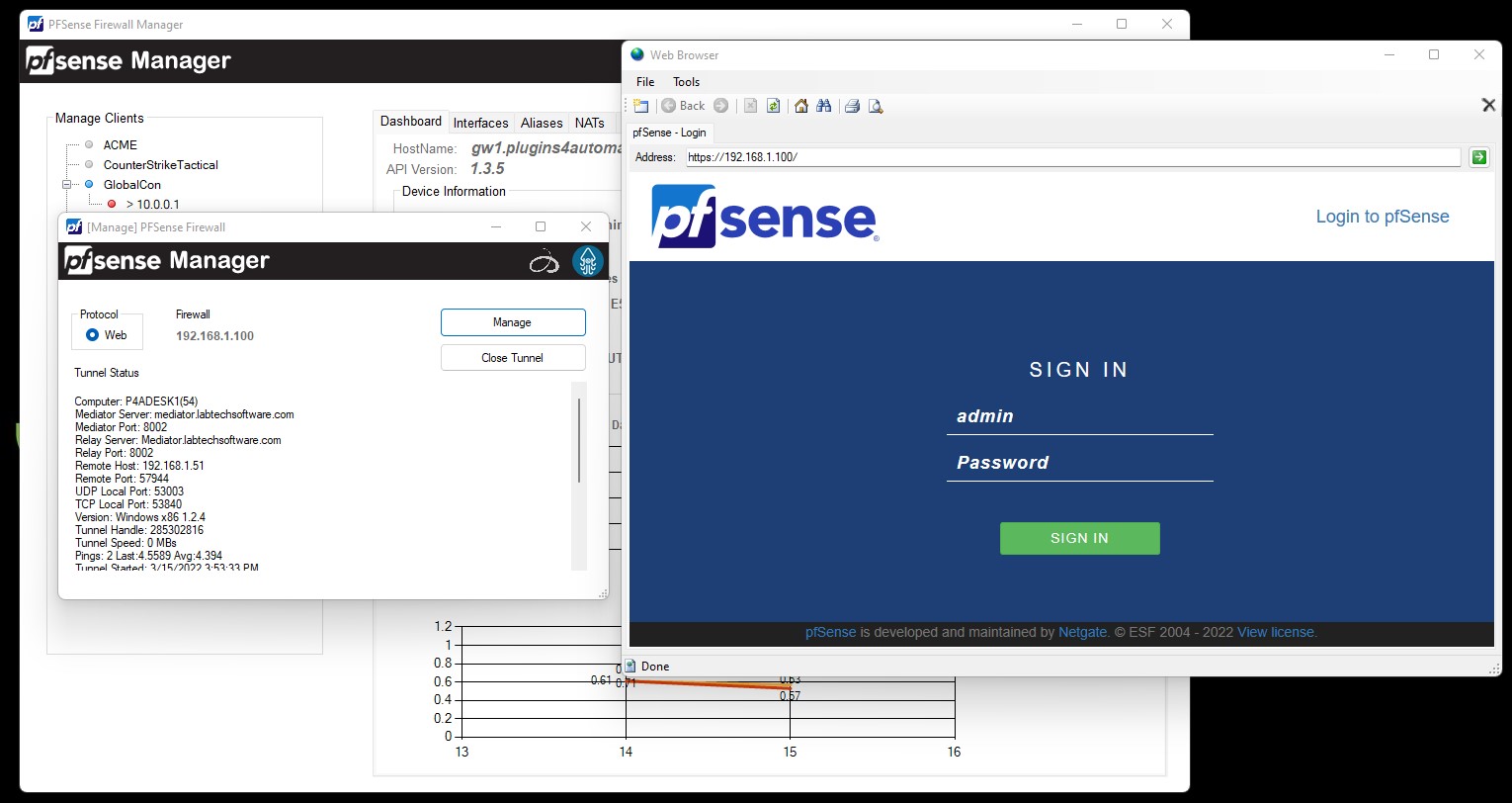

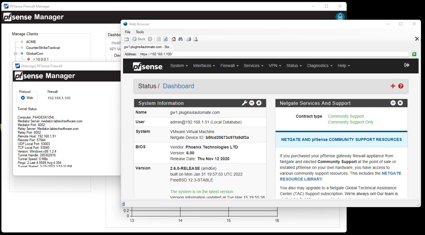

Go ahead and log in when page is loaded
You should now be logged in and able to use the interface.
