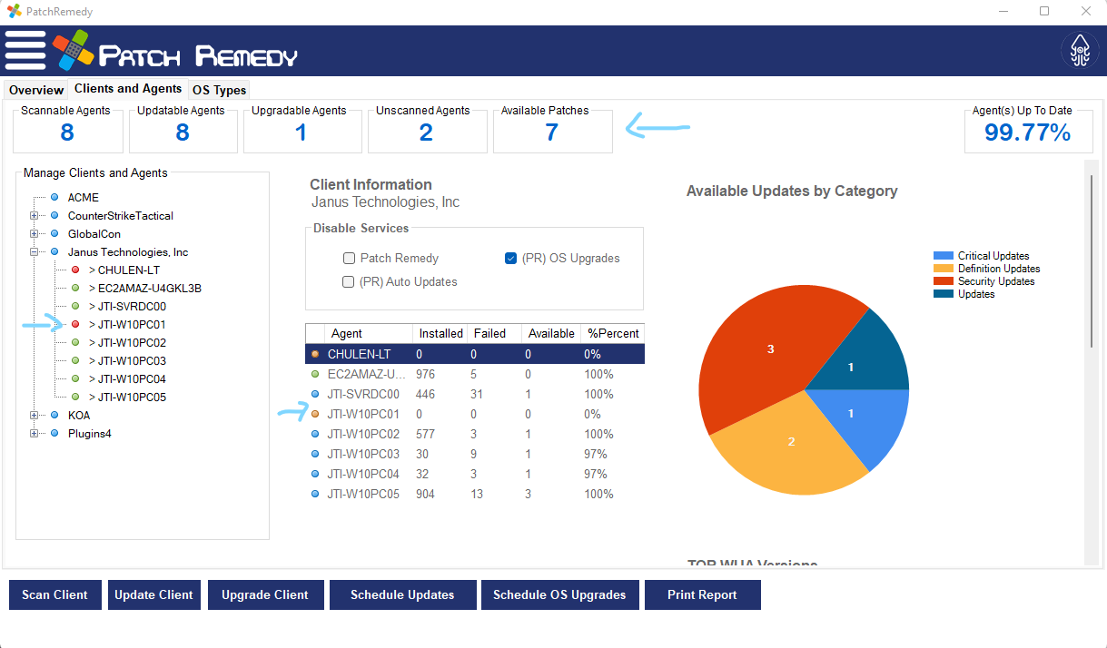

Posted: Thu Feb 24, 2022 1:20 pm
We provide percentages at all levels. When you select a client and the total client percentage is displayed, Also is displayed how that number is broken down by looking into the agents percentages in the list view of the clients view.
So although you get an over all percentage the same view shows who has what percentage.
A couple of other things to now note. You might notice that the dots are different colors (see blue arrows) In the client dropdown tree view, it tells you agent is offline. The more orangish color dot in the agent percentage view shows it is excluded from Patch Remedy and thus is not part of the percentages displayed. It also shows zeros across the board.
The other bule arrow points out a new counter in 1.0.5.6 that will display the actual count of available patches for client and or agent when selected.
1.0.5.6 has a minor bug fix and added counters. It was released last night so you should check your hosts plugin logs to see if the upgrade was seen by your automated updater.
