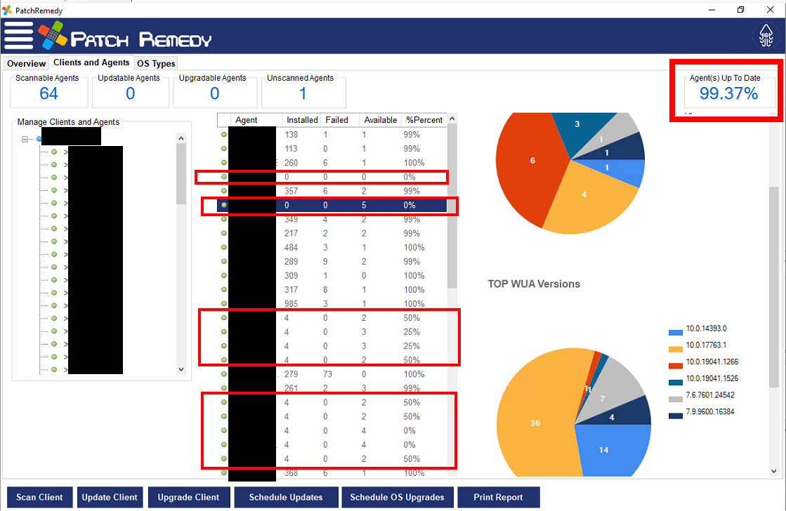

How is the calculation done? Looks like something is a bit off or I do not understand it. How can it be 99.37% for a client that have agents with so low coverage?

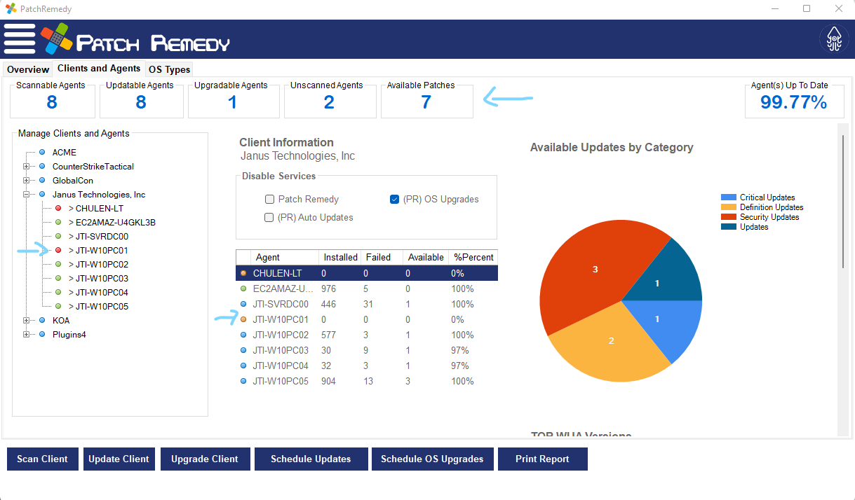

A couple of other things to now note. You might notice that the dots are different colors (see blue arrows) In the client dropdown tree view, it tells you agent is offline. The more orangish color dot in the agent percentage view shows it is excluded from Patch Remedy and thus is not part of the percentages displayed. It also shows zeros across the board.
The other bule arrow points out a new counter in 1.0.5.6 that will display the actual count of available patches for client and or agent when selected.
1.0.5.6 has a minor bug fix and added counters. It was released last night so you should check your hosts plugin logs to see if the upgrade was seen by your automated updater.
