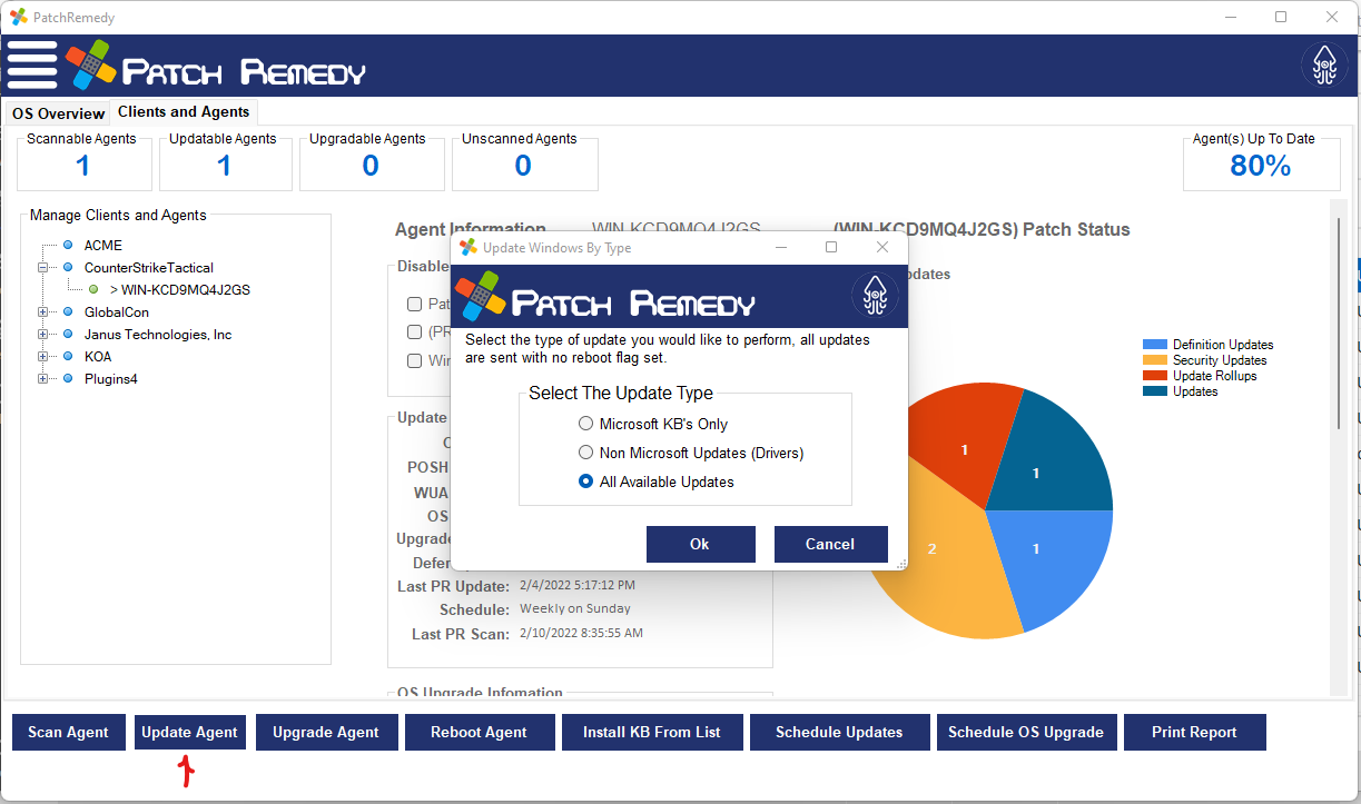

#1 Manual Update - (Update Agent/Client button) Depending on the current view this button will execute the install process for all known available patches for the given agent.

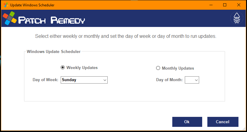

#2 Automate Updates - (Schedule Updates button) This will launch the scheduler for the automation. You are provided with to options. Weekly or Monthly.
Scheduler
When using the scheduler you need to know what view you are in. If you are view client data as a whole then the scheduler will schedule all agents under client. If you are looking at the agent view then the scheduler only effects the one agent.
This allows you to set the mass of agents as needed then fine tune the agents that may need a different schedule.

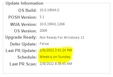

You can view the status of the schedule and its last execution by viewing the data in the Update fields.

Using the Manual Update Button
When selecting to update an agent or client you will be presented with an option to choose what type of update you want to perform.
Options are:
  • Microsoft KB's Only - Only install updates from Microsoft
  • Non Microsoft Updates - Install drivers only
  • All Available Updates - Have agent process all available updates.
