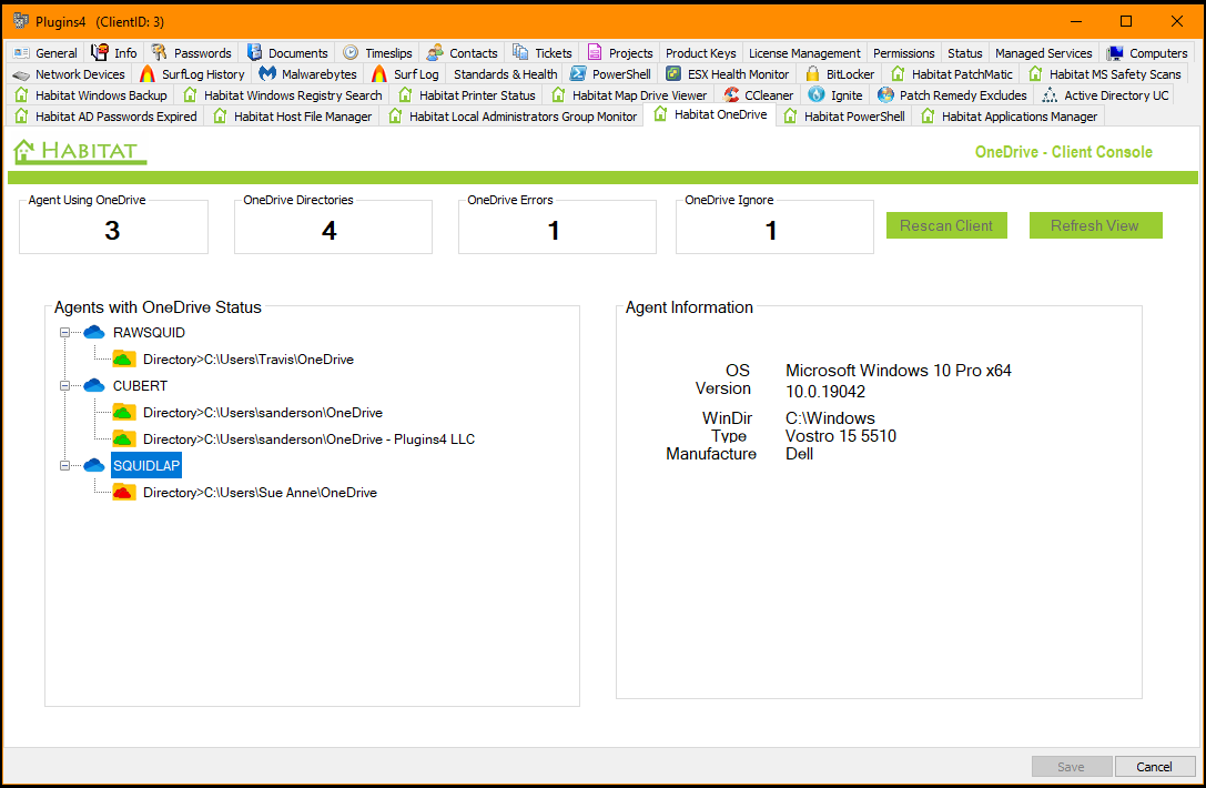

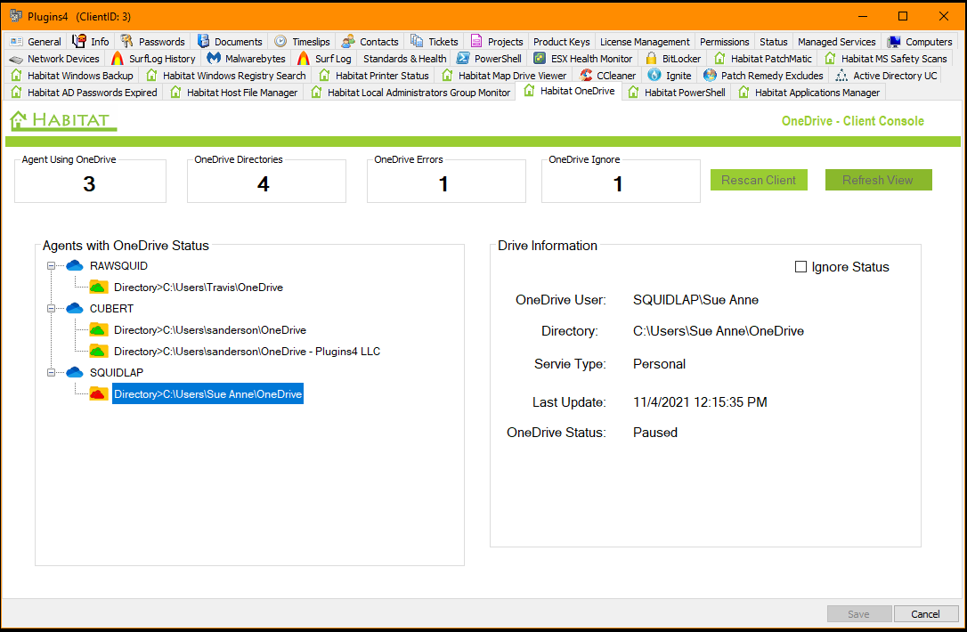

I am testing the onedrive monitor. I opened up the onedrive client console for my company in automate. my computer shows 4 valid onedrive folders, but only 1 of them is green, the other 3 are red. I checked onedrive and everything is syncing properly. Any idea why three would show red?

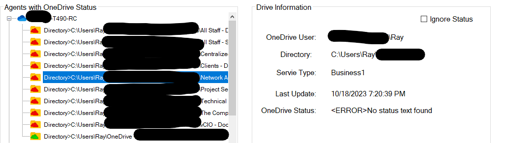

I have what appears to be the same thing happening.
Screenshot 2023-10-19 234413.png (40.21 KiB) Viewed 40747 times

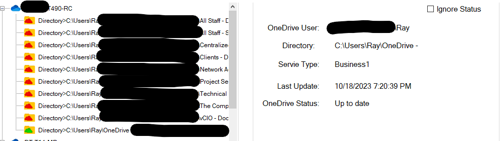

The one that works is a Personal Business OneDrive and show "Up to date", "Syncing", etc.. and the icon in File Explorer looks like this
Screenshot 2023-10-19 235010.png (635 Bytes) Viewed 40747 times
The one's that don't work are Teams Channels/SharePoint Library's that are synced to my computer.
Screenshot 2023-10-19 235605.png (43.93 KiB) Viewed 40747 times
They all show "<ERROR>No status text found>" and the icon in File Explorer, looks like this
Screenshot 2023-10-19 235132.png (409 Bytes) Viewed 40747 times
If I go through the process of using the .dll and PowerShell, the results for "Status String" is what I mentioned above and is shown in the image. <ERROR>No status text found>

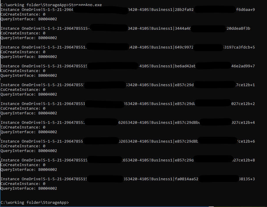

Re: Habitat OneDrive Monitor
Ok lest see if we can get some where with this issue.
Below is a small exe that you execute in a non admin command shell. It should spit out all the one drive connections the PC has.
The output looks like:
Screenshot 2023-10-20 091437.png (54.32 KiB) Viewed 40737 times
Run this and post your output here,
StorageApp.zip
(665.03 KiB) Downloaded 764 times
Post by ray@dominiontech.com »
So, when I run it on my computer in a non-elevated Command Prompt, this is what I get (with some of the strings obfuscated of course).
Screenshot 2023-10-20 191752.png (68.68 KiB) Viewed 40732 times
So, not as verbose as yours.

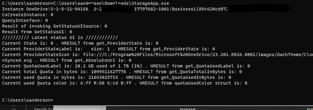

Actually neither are "mine". The same gentlemen that created the OneDriveLib powershell module also created this exe. I am reviewing the bug threads and several people are complaining that its not picking up the enterprise one drives statuses correctly.
I will keep my eyes open to see if they post any updates.
