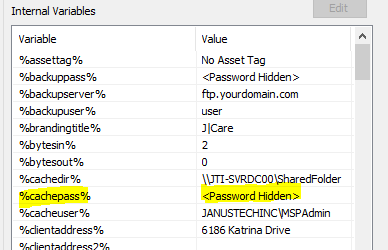

As I was writing this post I side-stepped over to creating a test script you could deploy to see if a client is "Ready" for caching at a give location. Well as I wrote this script I kept getting a error about the cache password being null or blank. Well at first it was my fault as the client I was testing really didn't have a password set, my brain fart...OK set the password and still the same result. Well here is that little "gotcha", when you assume something, it typically makes an ass of you.
Here is no different, I can see that the password is "Hidden" in the variables available but, I assumed that when in the script language it was reveled. The developers just didn't want it visible in the debugger.
However, this isn't so as I come to find out. I tried several methods to have it revel the actual passcode and every attempt returned null. So what's going on is that it is using the username but not passing the password as you would expect. If your share is fully accessible by everyone then this passes and all works as expected but if you expect the pass it fails to provide it as expected.
The funny thing is I can just query the locations table for it directly as my own variable so not sure why that is ... Automate is a fickle beast.
Anyhow I will be correcting this today and getting out another build to replace the current one.
I apologize to everyone that I didn't catch this oversight. our development agents and networks are not tightly secured so this got past us when configuring the share security.
