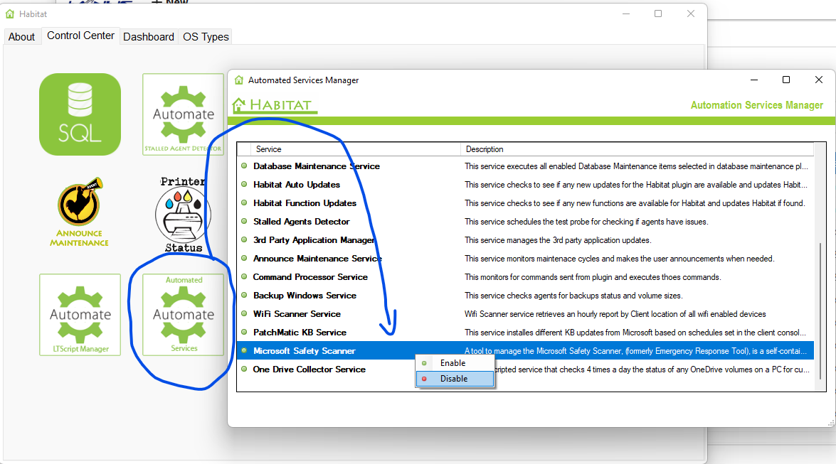

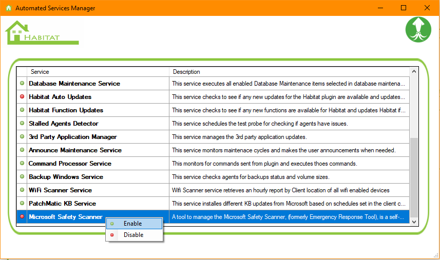

As with most Habitat tools that have some automation, there is a global enable/disable switch in the main Habitat consoles Automated Services manager tool. You will need to enable the service before automated services are available.
Automated services will scan, repair or both when configured to do so at the Client consoles. Each client must be configured to scan or repair independently of the global automation. Visit each Client console to allow automation to scan the agents of the client. Just turning on the global automation services will not start scans on agents. Each client will need to be configured to allow scans and or repairs to a given agent. Disabling the global services will stop all automation for this tool across all clients but will not stop manual scans and repairs.

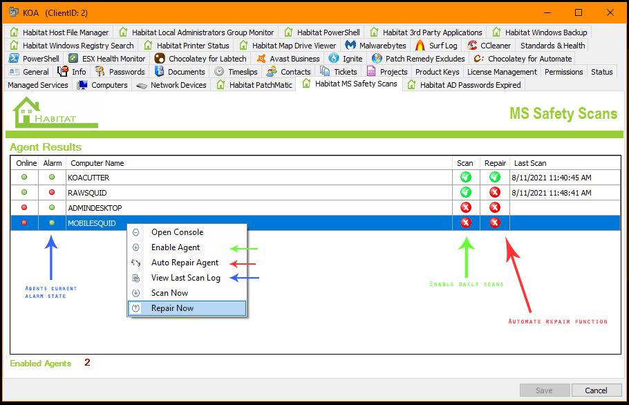

Client Console Tool Interface
Select an agent and then right click that agent to reveal menu of functions.
  • Open Console - Opens agent console
  • Enable Agent - Allow automated daily scans of the agent (Green is ON / Red is Off)
  • Auto Repair Agent - If previous scan reports errors then next scan would run the repair flag for MSERT (Green is On / Red is Off)
  • View Last Scan Log - Displays the last scan results from agent
  • Scan Now - Schedule a script to scan agent now
  • Repair Now - Schedule a script to run the repair function from MSERT now
You can monitor both the script and commands viewers from the agent console to see how and what the MSERT.exe returns if you need to trouble shoot an issue with an agent scanning.
The Client Console tool view shows each Microsoft agent and its current status by scan date. It shows the current configuration of an agent along with its current alarm status.

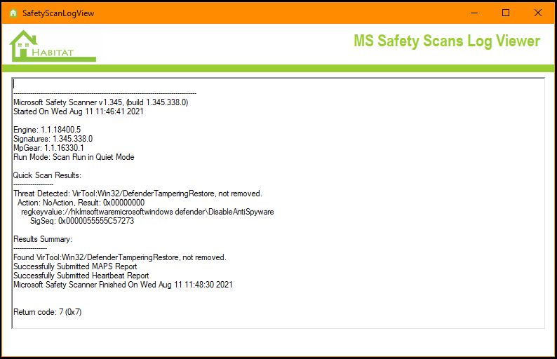

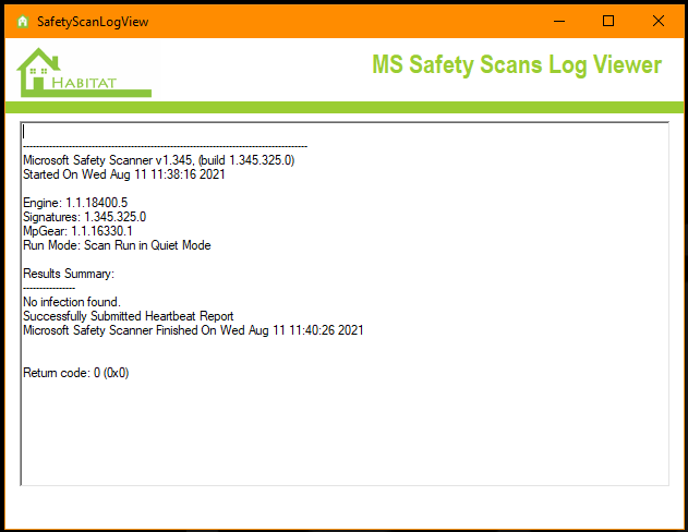

Alarm Status (Red is bad), You want to see green dots on each agent and a resent scan date. When an Alarm is good the expected log should look like the following image.
When the Alarm dot is red for an agent then view log should explain what it sees wrong.
You can manually and with Automation both scan and repair agents using the MSERT tool and its fully integrated into your Automate environment.

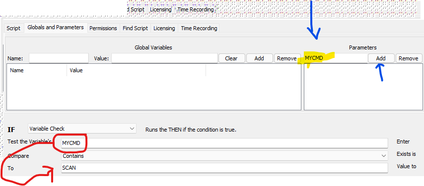

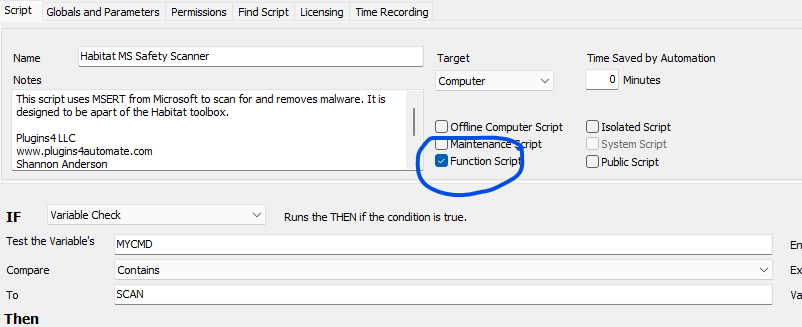

I can give you a work around for the current builds of Habitat.
Turn off the automated safety scanner automation. This will stop all automated scans of agents globally.

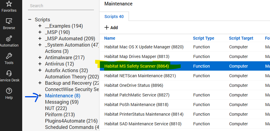

Next find, copy and edit the Habitat MS Safety Scanner script. Name it what you like.
Uncheck the Function Script check box so you can see the script.
Select the global and Params tab and add the "MYCMD" parameter. When you schedule the script you will need to pass the "SCAN" as the variable "MYCMD"
Save your script file and reload your Systems cache.

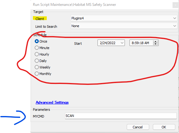

Next find the client you want to schedule and select client, select scripts, find your script name from scripts list and schedule it to run how you would like it to run. This will only effect the automated scanning function. All other features will continue to work as described.
You will however now need to schedule all clients/locations/agents you want to scan as Automation for scanning is off.
To get the value from the plugin functions I would stay with at least a weekly schedule. You can push it out to monthly but may be putting yourself at more risk with little to no extra benefit.
