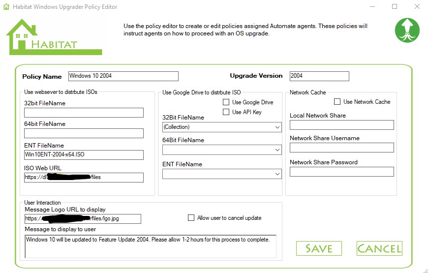

Please post screenshot of your policy for the installs
Screenshot 2021-05-10 103254.jpg (96.74 KiB) Viewed 8937 times
I've tried with both the ENT iso listed or the 32/64 bit iso's, same result either way.
Re: WIndows Ugrade Assistant - ISO download failure
Ok so by your config I see your only downloading Enterprise Windows 10 and neither the 64 or 32 bit versions of PRO.
So We should be looking at that part of the script code to see what it is doing.
Since you say it dies pretty much strait away that tells us that we either have a bad URL or some other (get from URL) issue.

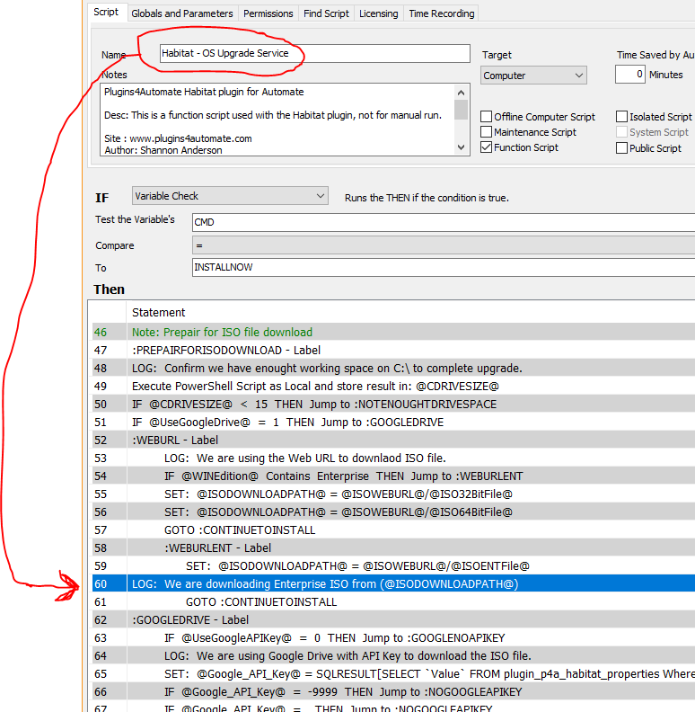

To test this theory, lets open the Scripts\Maintenance\Habitat - OS Upgrade Service script and in the "Then" section lets add a new line at line 60.
The new line should be a "script log message" function and place in the log line the variable "@ISODOWNLOADPATH@" which will print out the URL it will attempt to fetch.
Lets see what it logs as a URL to see if it got malformed in some way.
You should now get a log message during the running of script that will print out this URL.
Between Line 52 and 60 we construct the URL from the entries placed in the configs for 32 bit, 64 bit and Enterprise. If for some reason your grabbing incorrect data then URL will be malformed here and we should be able to see that in the logs during an update attempt.

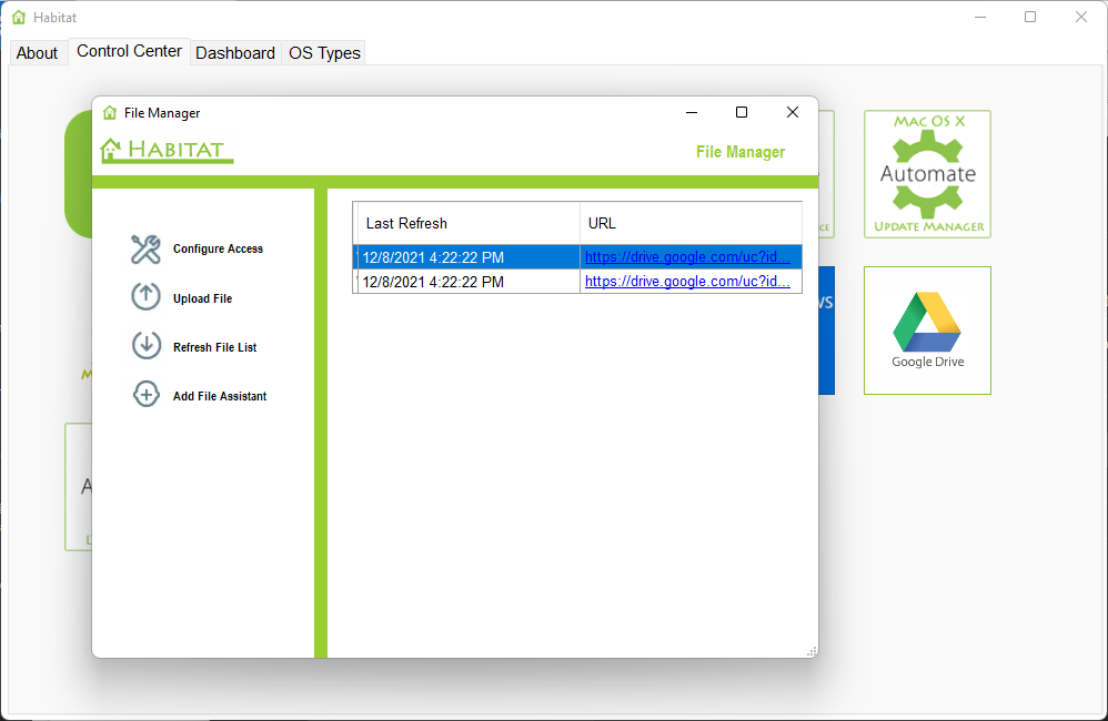

I'm having a similar issue where the download fails but I'm using the Google Drive API. It's seeing the files, but if I try to download the file from the Google Drive File Manager I get Access denied?
Did I possibly miss something in configuration steps again?

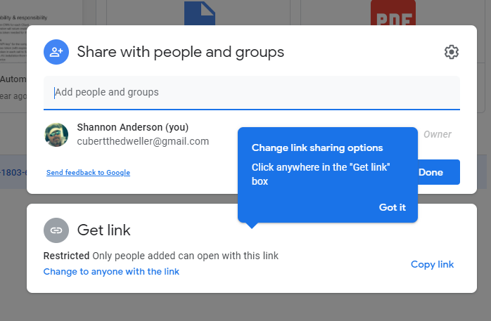

Sounds like your issue is with the uploaded file permissions. Go into Google Drive and allow it to be shared by only the link and not restricted to users.

That was it thank you very much file is now downloading :D :D :D :D
