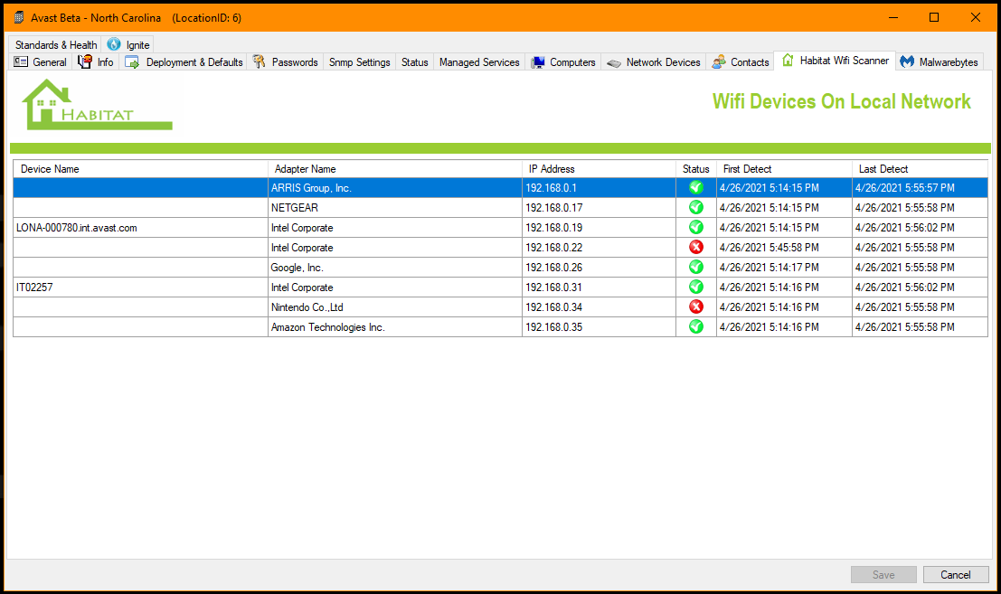

We added a new tool to Habitat that is available at any "location" where an active agent is using Wifi.
The scanner sees the active agent and will execute a small script that takes just seconds to complete. It quickly captures the devices it sees on the active wifi adaptor on the agent and imports them into the Automate database where we keep track them.
An active location may look some thing like this:
Showing you the game systems, Audio(Listening Devices), Cell phones, TV and Smart card devices, PC, switches and routers. See when they showed up on the network, if they are still on the network and when the last time we saw them on the network.
This is all useful information when you need to know how network resources at a given location are being utilized.
