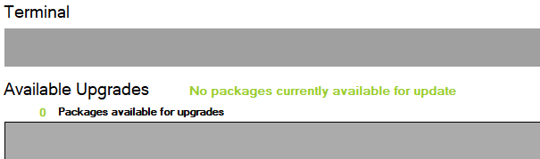

The Linux update agent is show wrong or no info.
Please see attached file for pictures.
Servers har been rebooted 10 times last 12 hours.
Patches dont installt etc etc etc
Reboot dont work either from the Update Manager.
When I look a server scripts/command it says Ok....
Standard Ubunut servers version 16-20
What Im a missing ?
What more info can I provide to get some help ?

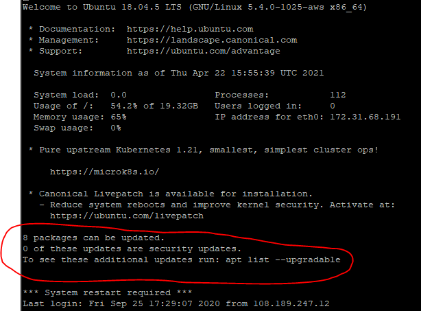

The first script (Python) /root/apt-get/APT-GET-Check.py returns 2 numbers separated by a semicolon of updates available and security updates available. In the example it is returning [8;0]
It will typically match what you see when you SSH into the agent and get a standard terminal.

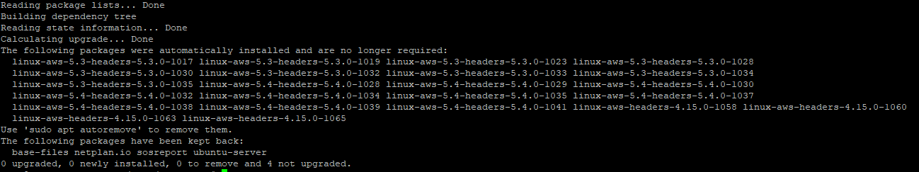

The output of this command un-parsed by plugin looks like the following.
As you can see from this output that there are no packages reported back in the output.
This is typical for Ubuntu (Debian style) system to report some small set of distro packages that are optional updates. So it shows them in the overall count but not when you ask Apt-Get to show them.
This then causes the first scripts numbers to be recorded (8 non security and 0 security) updates but listed zero in the actual app list.

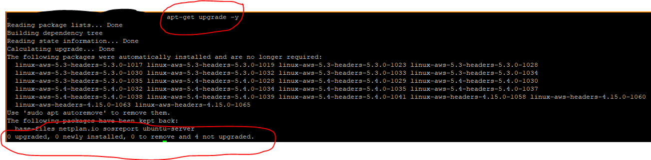

Now lets just run a manual upgrade everything command on agent to Agt-get (apt-get upgrade -Y)
As you can see it upgrade 0 files. Where are those 8 applications that should now update? These 8 files are New Kernel files and such. In the current version of LUM we do not offer a Disto Update so even though the system is being updated it is not changing the kernels.

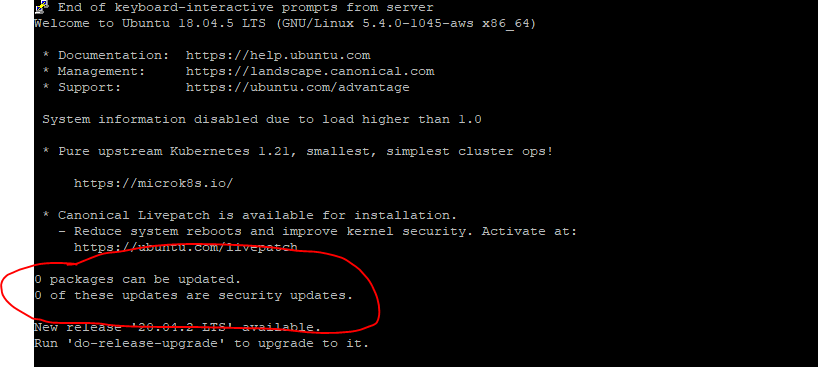

After we ran the disto updates and rebooted the following MOTD shows packages gone.
And if we now rescan via the plugin we see those updates are now gone.
So the plugin is working, just with Distro updates turned off and no forced reboots.
