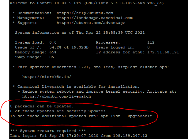

The first script (Python) /root/apt-get/APT-GET-Check.py returns 2 numbers separated by a semicolon of updates available and security updates available. In the example it is returning [8;0]
It will typically match what you see when you SSH into the agent and get a standard terminal.

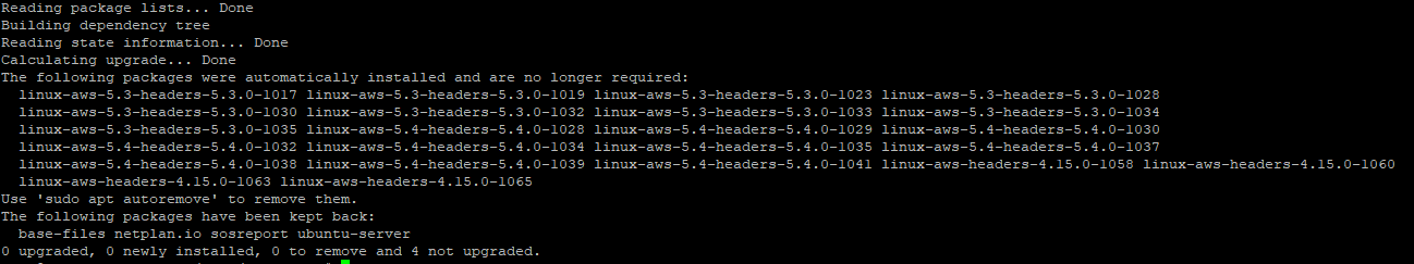

The output of this command un-parsed by plugin looks like the following.
As you can see from this output that there are no packages reported back in the output.
This is typical for Ubuntu (Debian style) system to report some small set of distro packages that are optional updates. So it shows them in the overall count but not when you ask Apt-Get to show them.
This then causes the first scripts numbers to be recorded (8 non security and 0 security) updates but listed zero in the actual app list.

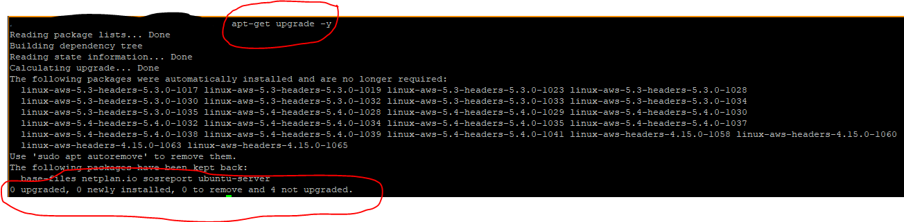

Now lets just run a manual upgrade everything command on agent to Agt-get (apt-get upgrade -Y)
As you can see it upgrade 0 files. Where are those 8 applications that should now update? These 8 files are New Kernel files and such. In the current version of LUM we do not offer a Disto Update so even though the system is being updated it is not changing the kernels.

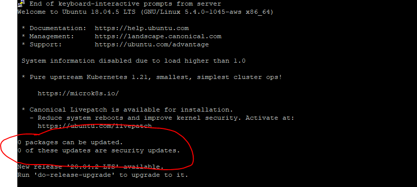

I will look into adding feature to choose this ability but will not resolve the issue of visibility of packages. They will still remain invisible to the plugin.
After we ran the disto updates and rebooted the following MOTD shows packages gone.
And if we now rescan via the plugin we see those updates are now gone.
So the plugin is working, just with Distro updates turned off and no forced reboots.

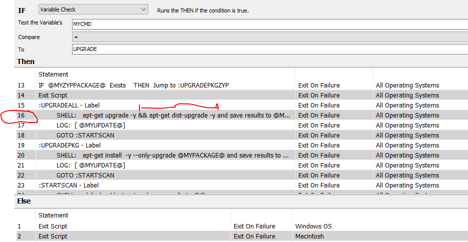

Re: Showiing wrong or no info
So your short term work around would be to edit the Automate script adding to line 16 of the THEN section to include
&& apt-get dist-upgrade - y
So that when the Update All is given that it does the hidden updates as well. This will not force the reboot but you can add a new line after 16 to send reboot command down, then a script function to sleep 3 minutes while reboot happens. So script can continue with script scans after updates.
Post by stefan@nssonab.se »
Hi
I have addes the suggestions line. but still same issue.
And the scans are not running auto update either.
Last scan in the plugin is not up to date
