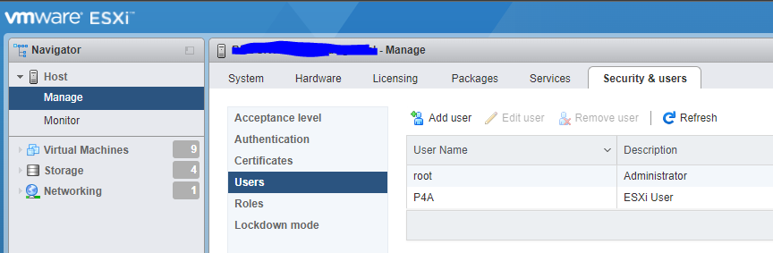

Login to host with current root credentials. Navigate to Host > Manage > Security and Users > Users > Select Add User

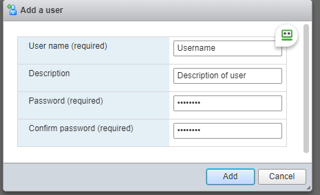

Create the new user and password and select Add.

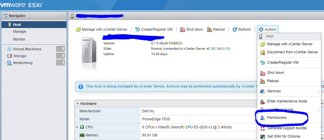

Navigate to Host > Actions > Permissions

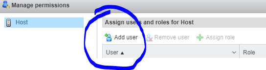

Click on Add User

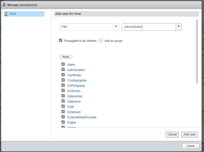

Select Drop to Select a user and Select the user Role and click Add
Select Close

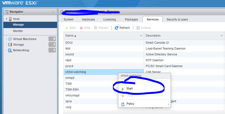

Now let’s ensure CIM Services are running. Navigate to Host > Manage > Services
Locate the sfcdb-watchdog (CIM Server) and right click and select start
