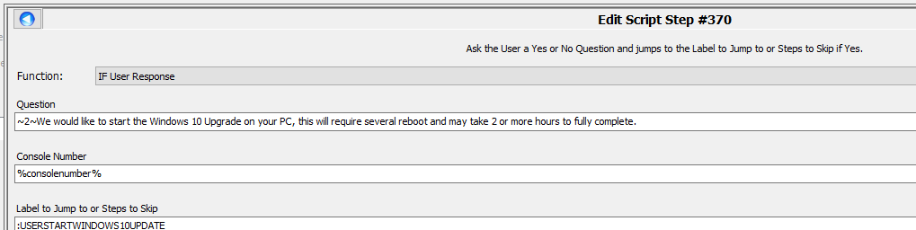

As to point #2 we are limited to the options for "If User Response" script function.
We are offered a "Yes/No" response where yes will pass you to the next step and no will exit script. A non response is considered a no, which exits the script before we can retake control. We could play some word magic to reverse the question but then we would introduce a new problem with MSPs whom expected a different outcome.
Perfectly understandable - and actually I was just running some tests and it already is Ask Then Deny! I'm not sure where the complaints were coming from now from these users about missing the prompt and it going on anyways. Either way, looks like this is already set up as we'd want, despite what I was hearing.
