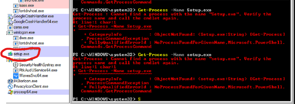

On a side note I found a bug with how it detects if setup is still running. I had a bad ISO cached at one location and this was causing setup.exe to pop a error box in the background and just never close out, which then prevented future runs. The key is that the process name in line 295 has to leave off the .exe i.e. use setup instead of setup.exe. The latter doesn't pick up even if it is running at that exact moment.
