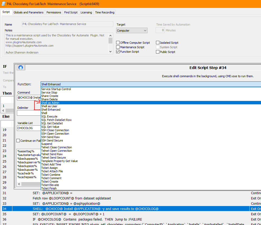

Edit Scripts/Maintenance/P4L Chocolatey For LabTech Maintenance Service

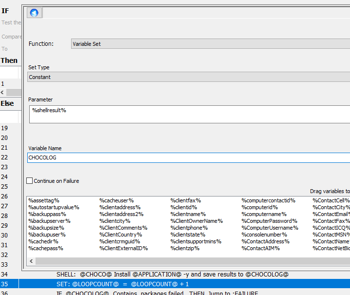

On line 34 of the ELSE section change the shell type from Shell Enhanced to Shell as Admin
Afterwards you will need to add a new line just below line 34 that saves "ShellResult" to "CHOCOLOG" variable name so we can continue to test outputs for success and failure.
See if that resolves your install issues. If so we can look to add this as a switch in the plugin so if selected it will force this command type verses the normal shell enhance.
