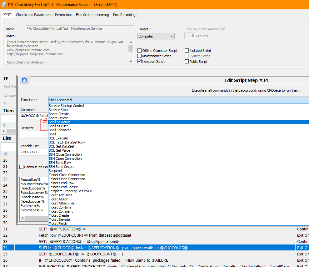

Try this,
Edit Scripts/Maintenance/P4L Chocolatey For LabTech Maintenance Service
On line 34 of the ELSE section change the shell type from Shell Enhanced to Shell as Admin

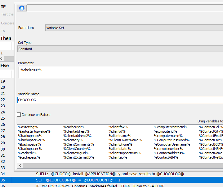

Afterwards you will need to add a new line just below line 34 that saves "ShellResult" to "CHOCOLOG" variable name so we can continue to test outputs for success and failure.
See if that resolves your install issues. If so we can look to add this as a switch in the plugin so if selected it will force this command type verses the normal shell enhance.

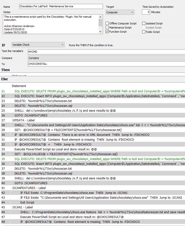

Thank you SO much for clearing that up! I don't have a script that starts with "P4L", but I do have one for "Chocolately For LabTech Maintenance Service". However, the "Else" section doesn't look like yours.
- Capture.JPG (178.56 KiB) Viewed 15167 times
Re: Auto-Install failing. "Access to the path 'C:\ProgramData\chocolatey\lib\"
Ah ok then your using Version 2 of Chocolatey For Automate.
Send me a scree shot of the global manager screen so I can confirm the build.
It will be a very similar change in script just a different script.

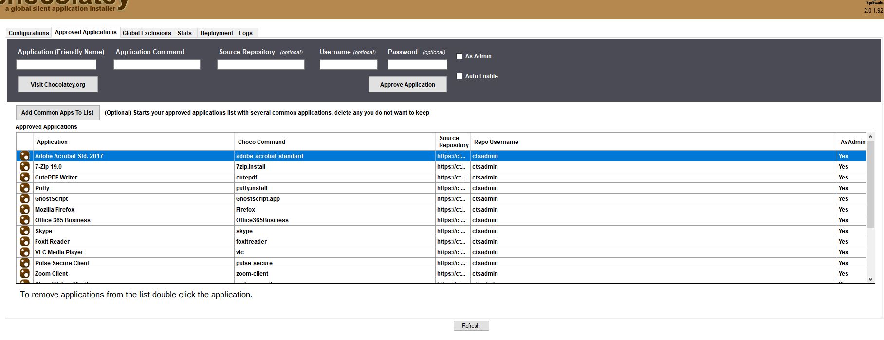

Ok if you are using version 2 then there should be a "As Admin" checkbox available when adding a package to the global app manager view.
This instructs the system to install application using this function. So all you should need do is modify the package in the global manager to include this checked box.
"As Admin" was checked on all our apps when we initially configured this. The auto-installs were running at one point (last fall I believe) but then they suddenly stopped and haven't worked since. I removed the apps from the global and re-added them "As Admin" but we're still not getting auto-installs to work.
aaroncampbell72
- Posts: 33
- Joined: Tue Mar 24, 2020 6:59 pm
- 6
Here's a screenshot of the app screen.
- Capture.JPG (165.03 KiB) Viewed 15114 times
Looks like your on Version 2.0.1.92 You need to update the plugin manually.
We are on 2.0.1.103 which is 11 different updates from the version your on.
The plugin build 2.0.1.103
https://delivery.shopifyapps.com/-/39d4 ... d8b1c52f10
Here is the how-to update plugins guide.
https://www.plugins4labtech.com/pages/h ... to-labtech
Afterwards restart the DBagent on the automate server, close all tech consoles and relaunch them again to see new updates and version build numbers.
If after the update you still see the old build number then your having a permission issue on tech workstation where as it is not allowing the new DLL to download from Automate host to local tech computer.
