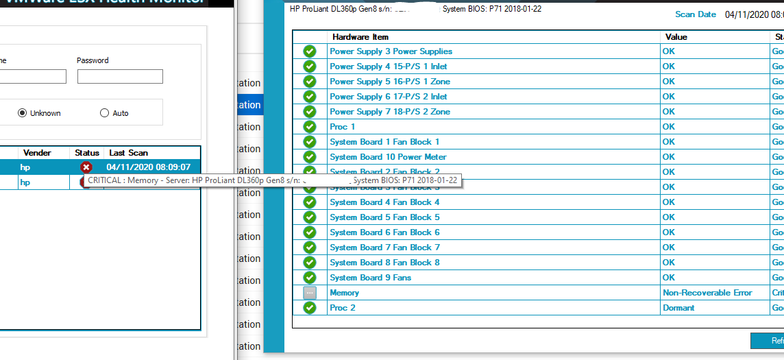

So we have "Memory" returning false positive data on two hosts, so I went into the CIM data field and Disabled that specific one but it still logs tickets every time.
I've attached a screenshot of it being disabled and it still showing critical in the main view, all of the other options are green.
Alerting even when CIM is disabled
- Capture.PNG (82.99 KiB) Viewed 41680 times

In your image, the first screen has a red X on it. If you hover you mouse over it it will provide the full status line for the ESX host. Can you post that information here?
This main status is set directly from a CIM status request so the ESX host believes its in error as it is reporting back "Error". After this first request we request CIM data for hardware. (ESX Host status / Hardware Status)

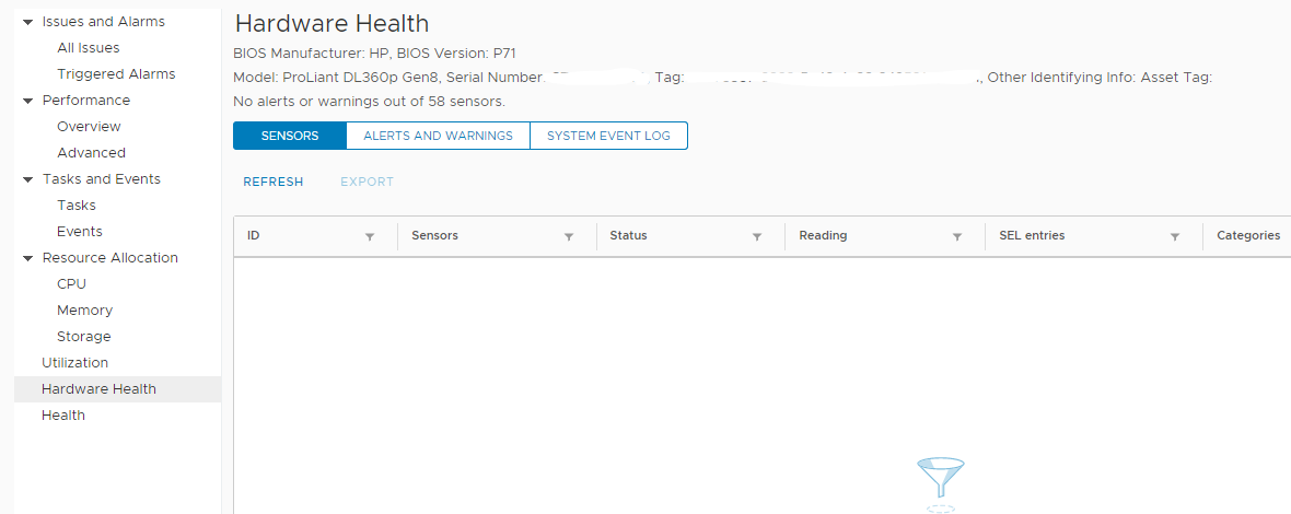

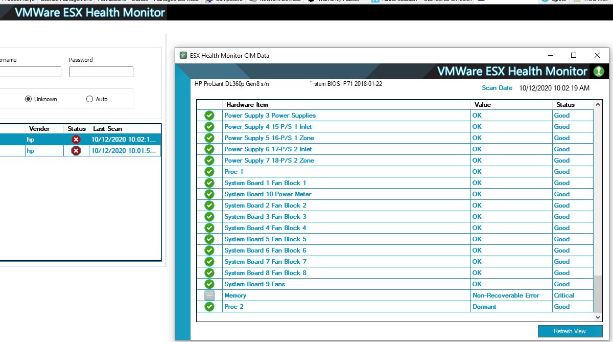

Here's screenshots of everything I think will help
The fact both hosts are returning the same error, it's got to be a BIOS bug or something in VMware, because vCenter shows no errors yet when you query directly it does. If there's anything you want me to do further let me know, I can have SSH access directly to the hosts if you need me to
- Capture.PNG (37.65 KiB) Viewed 41227 times
- errors.PNG (69.32 KiB) Viewed 41227 times
