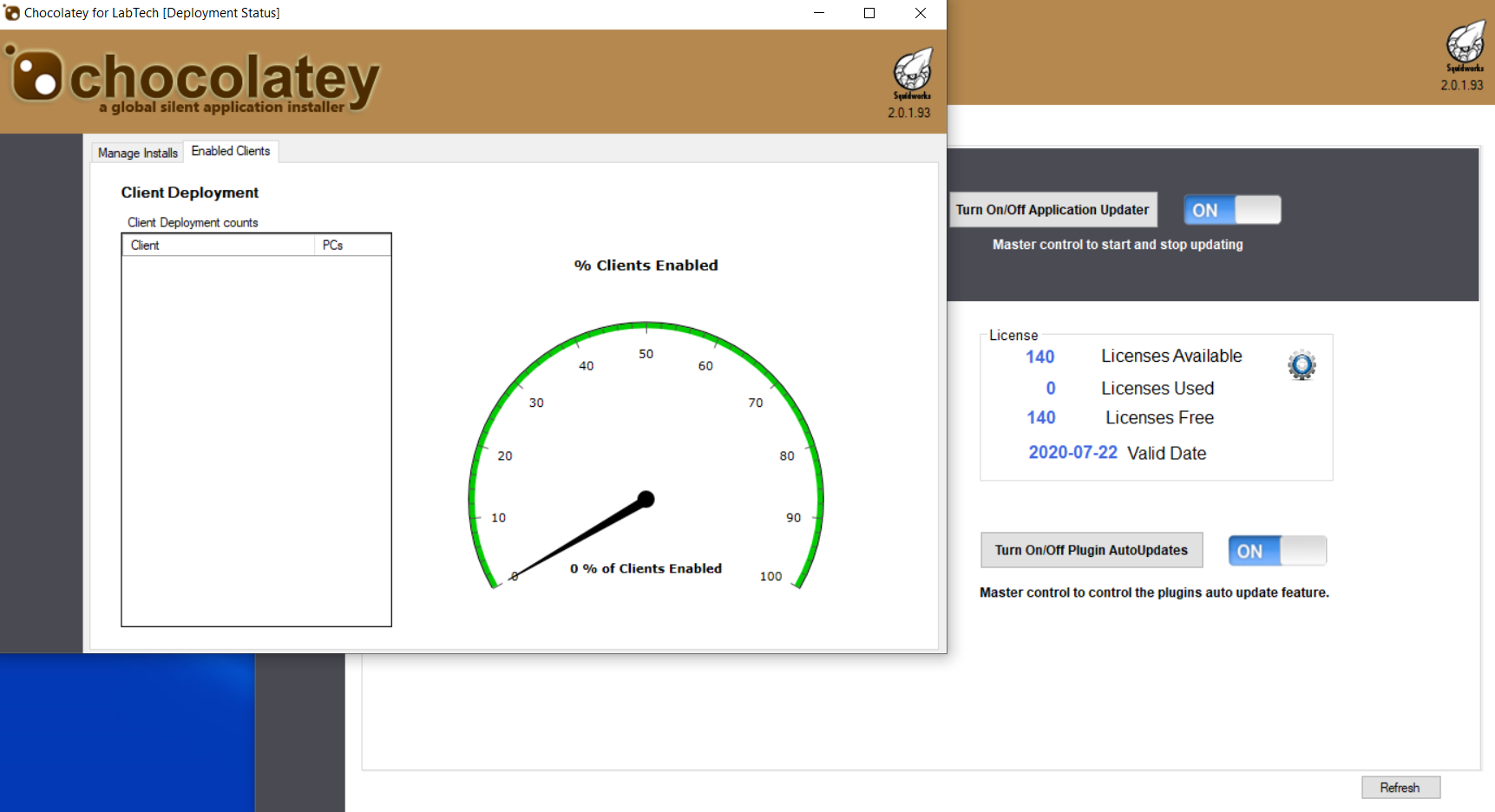

Since the new licenses were added we are unable to get Chocolatey to install on any computer. I am looking through the configuration of Chocolatey and it shows none of our clients are enabled. I went to each client to check if it was disabled but it was not. I have attached screenshots of the issue.
Choco 1.PNG (226.53 KiB) Viewed 5738 times
Choco 2.PNG (258.81 KiB) Viewed 5738 times

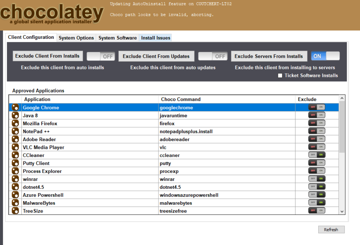

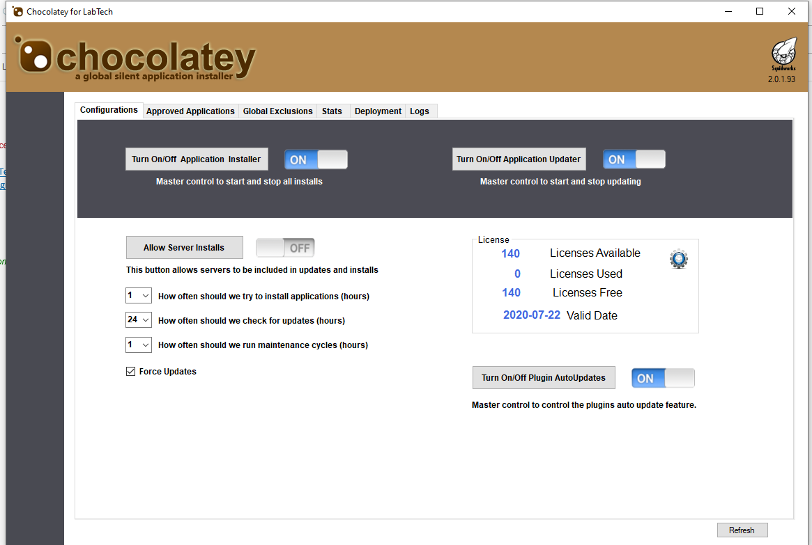

Hi
Attached is the picture of logs we see. We cannot see anything within the log. I have went to a new computer and we see the scripts run successfully but at the top of the Chocolatey we see "This feature is disabled until Chocolatey Maintenance has run".
