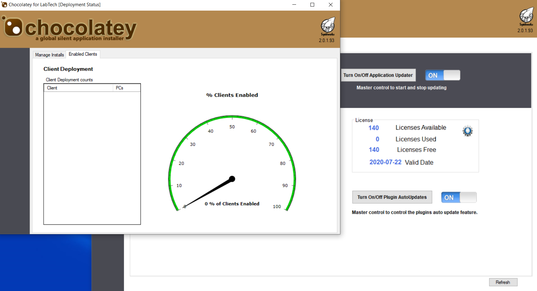

Since the new licenses were added we are unable to get Chocolatey to install on any computer. I am looking through the configuration of Chocolatey and it shows none of our clients are enabled. I went to each client to check if it was disabled but it was not. I have attached screenshots of the issue.

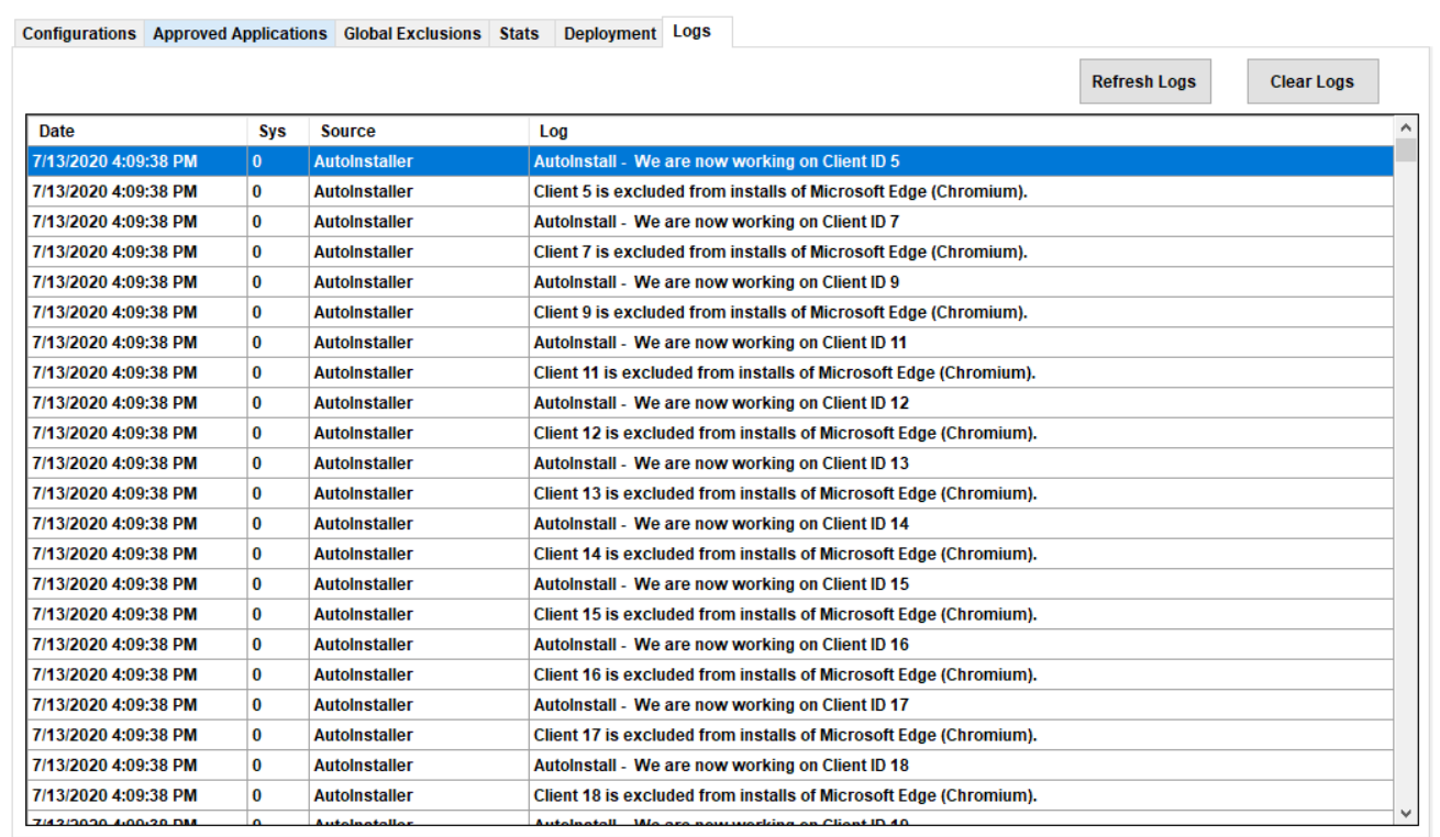

Attached is the picture of logs we see. We cannot see anything within the log. I have went to a new computer and we see the scripts run successfully but at the top of the Chocolatey we see "This feature is disabled until Chocolatey Maintenance has run".
