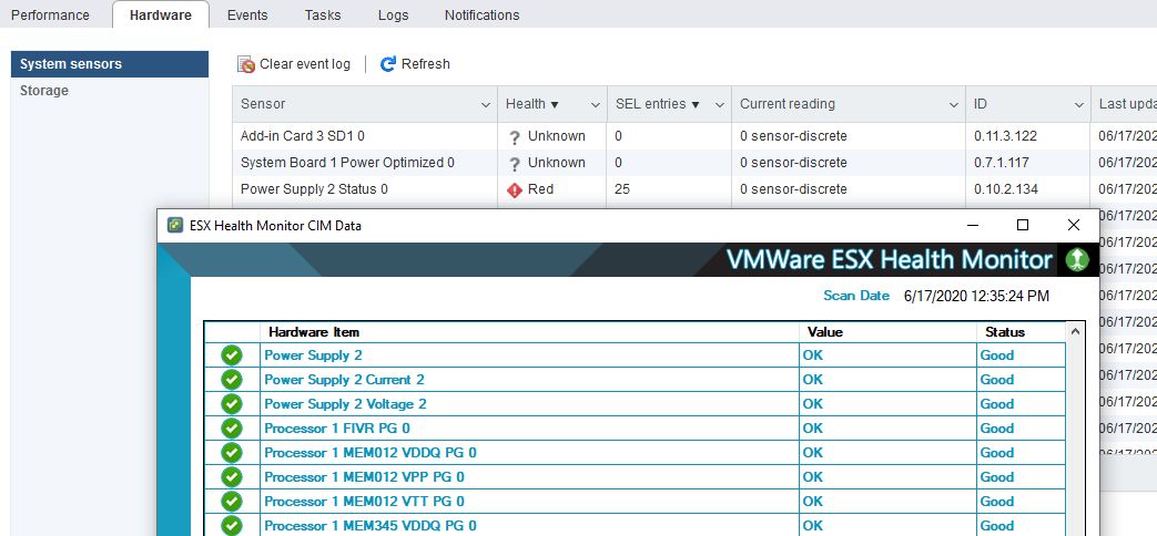

Failed to Alert
Posted: Wed Jun 17, 2020 5:43 pm
by MrRat
The plugin missed an issue.
VMWare and the iDRAC show the hardware issue. The plugin says it just updated and is Ok and Good.
esx bad.jpg (81.42 KiB) Viewed 21201 times

I seem to be having the same problem as Mr. Rat. I ran the probe test you linked and got an Element Op Status=2. Below are my results:

20201007 09:12:41 Element Name = System Board 1 Drive 0 7: Drive Present
20201007 09:12:41 Element Name = System Board 1 Drive 0 7: Drive Fault
20201007 09:12:41 Element Op Status = 2
20201007 09:12:41 Element Name = System Board 1 Drive 0 7: Predictive Failure
20201007 09:12:41 Element Name = System Board 1 Drive 0 7: Hot Spare
20201007 09:12:41 Element Name = System Board 1 Drive 0 7: Parity Check In Progress
20201007 09:12:41 Element Name = System Board 1 Drive 0 7: In Critical Array
20201007 09:12:41 Element Name = System Board 1 Drive 0 7: In Failed Array
20201007 09:12:41 Element Name = System Board 1 Drive 0 7: Rebuild In Progress
20201007 09:12:41 Element Name = System Board 1 Drive 0 7: Rebuild Aborted
20201007 09:12:41 Element Name = System Board 1 Drive 0 6: Drive Present
20201007 09:12:41 Element Name = System Board 1 Drive 0 6: Drive Fault
20201007 09:12:41 Element Name = System Board 1 Drive 0 6: Predictive Failure
20201007 09:12:41 Element Name = System Board 1 Drive 0 6: Hot Spare
20201007 09:12:41 Element Name = System Board 1 Drive 0 6: Parity Check In Progress
20201007 09:12:41 Element Name = System Board 1 Drive 0 6: In Critical Array
20201007 09:12:41 Element Name = System Board 1 Drive 0 6: In Failed Array
20201007 09:12:41 Element Name = System Board 1 Drive 0 6: Rebuild In Progress
20201007 09:12:41 Element Name = System Board 1 Drive 0 6: Rebuild Aborted
20201007 09:12:41 Element Name = System Board 1 Drive 0 5: Drive Present
20201007 09:12:41 Element Name = System Board 1 Drive 0 5: Drive Fault
20201007 09:12:41 Element Name = System Board 1 Drive 0 5: Predictive Failure
20201007 09:12:41 Element Name = System Board 1 Drive 0 5: Hot Spare
20201007 09:12:41 Element Name = System Board 1 Drive 0 5: Parity Check In Progress
20201007 09:12:41 Element Name = System Board 1 Drive 0 5: In Critical Array
20201007 09:12:41 Element Name = System Board 1 Drive 0 5: In Failed Array
20201007 09:12:41 Element Name = System Board 1 Drive 0 5: Rebuild In Progress
20201007 09:12:41 Element Name = System Board 1 Drive 0 5: Rebuild Aborted
20201007 09:12:41 Element Name = System Board 1 Drive 0 4: Drive Present
20201007 09:12:41 Element Name = System Board 1 Drive 0 4: Drive Fault
20201007 09:12:41 Element Name = System Board 1 Drive 0 4: Predictive Failure
20201007 09:12:41 Element Name = System Board 1 Drive 0 4: Hot Spare
20201007 09:12:41 Element Name = System Board 1 Drive 0 4: Parity Check In Progress
20201007 09:12:41 Element Name = System Board 1 Drive 0 4: In Critical Array
20201007 09:12:41 Element Name = System Board 1 Drive 0 4: In Failed Array
20201007 09:12:41 Element Name = System Board 1 Drive 0 4: Rebuild In Progress
20201007 09:12:41 Element Name = System Board 1 Drive 0 4: Rebuild Aborted
20201007 09:12:41 Element Name = System Board 1 Drive 0 3: Drive Present
20201007 09:12:41 Element Name = System Board 1 Drive 0 3: Drive Fault
20201007 09:12:41 Element Name = System Board 1 Drive 0 3: Predictive Failure
20201007 09:12:41 Element Name = System Board 1 Drive 0 3: Hot Spare
20201007 09:12:41 Element Name = System Board 1 Drive 0 3: Parity Check In Progress
20201007 09:12:41 Element Name = System Board 1 Drive 0 3: In Critical Array
20201007 09:12:41 Element Name = System Board 1 Drive 0 3: In Failed Array
20201007 09:12:41 Element Name = System Board 1 Drive 0 3: Rebuild In Progress
20201007 09:12:41 Element Name = System Board 1 Drive 0 3: Rebuild Aborted
20201007 09:12:41 Element Name = System Board 1 Drive 0 2: Drive Present
20201007 09:12:41 Element Name = System Board 1 Drive 0 2: Drive Fault
20201007 09:12:41 Element Name = System Board 1 Drive 0 2: Predictive Failure
20201007 09:12:41 Element Name = System Board 1 Drive 0 2: Hot Spare
20201007 09:12:41 Element Name = System Board 1 Drive 0 2: Parity Check In Progress
20201007 09:12:41 Element Name = System Board 1 Drive 0 2: In Critical Array
20201007 09:12:41 Element Name = System Board 1 Drive 0 2: In Failed Array
20201007 09:12:41 Element Name = System Board 1 Drive 0 2: Rebuild In Progress
20201007 09:12:41 Element Name = System Board 1 Drive 0 2: Rebuild Aborted
20201007 09:12:41 Element Name = System Board 1 Drive 0 1: Drive Present
20201007 09:12:41 Element Name = System Board 1 Drive 0 1: Drive Fault
20201007 09:12:41 Element Name = System Board 1 Drive 0 1: Predictive Failure
20201007 09:12:41 Element Name = System Board 1 Drive 0 1: Hot Spare
20201007 09:12:41 Element Name = System Board 1 Drive 0 1: Parity Check In Progress
20201007 09:12:41 Element Name = System Board 1 Drive 0 1: In Critical Array
20201007 09:12:41 Element Name = System Board 1 Drive 0 1: In Failed Array
20201007 09:12:41 Element Name = System Board 1 Drive 0 1: Rebuild In Progress
20201007 09:12:41 Element Name = System Board 1 Drive 0 1: Rebuild Aborted
20201007 09:12:41 Element Name = System Board 1 Drive 0 0: Drive Present
20201007 09:12:41 Element Name = System Board 1 Drive 0 0: Drive Fault
20201007 09:12:41 Element Name = System Board 1 Drive 0 0: Predictive Failure
20201007 09:12:41 Element Name = System Board 1 Drive 0 0: Hot Spare
20201007 09:12:41 Element Name = System Board 1 Drive 0 0: Parity Check In Progress
20201007 09:12:41 Element Name = System Board 1 Drive 0 0: In Critical Array
20201007 09:12:41 Element Name = System Board 1 Drive 0 0: In Failed Array
20201007 09:12:41 Element Name = System Board 1 Drive 0 0: Rebuild In Progress
20201007 09:12:41 Element Name = System Board 1 Drive 0 0: Rebuild Aborted
20201007 09:12:41 Element Name = Add-in Card 3 Redundancy 0
20201007 09:12:41 Element Name = Add-in Card 3 SD2 0: Unknown
20201007 09:12:41 Element Name = Add-in Card 3 SD1 0: Unknown
20201007 09:12:41 Element Name = System Board 1 Power Optimized 0: OEM
20201007 09:12:41 Element Name = System Board 1 Power Optimized 0: Unknown
20201007 09:12:41 Element Name = Power Supply 2 Status 0: Presence detected
20201007 09:12:41 Element Name = Power Supply 2 Status 0: Failure status
20201007 09:12:41 Element Name = Power Supply 2 Status 0: Predictive failure
20201007 09:12:41 Element Name = Power Supply 2 Status 0: Power Supply AC lost
20201007 09:12:41 Element Name = Power Supply 2 Status 0: Config Error: Vendor Mismatch
20201007 09:12:41 Element Name = Power Supply 1 Status 0: Presence detected
20201007 09:12:41 Element Name = Power Supply 1 Status 0: Failure status
20201007 09:12:41 Element Name = Power Supply 1 Status 0: Predictive failure
20201007 09:12:41 Element Name = Power Supply 1 Status 0: Power Supply AC lost
20201007 09:12:41 Element Name = Power Supply 1 Status 0: Config Error: Vendor Mismatch
20201007 09:12:41 Element Name = System Board 1 PS Redundancy 0
20201007 09:12:41 Element Name = Disk Drive Bay 1 BP1 Presence 0: Present
20201007 09:12:41 Element Name = Disk Drive Bay 1 BP1 Presence 0: Absent
20201007 09:12:41 Element Name = System Board 1 CMOS Battery 0: Low
20201007 09:12:41 Element Name = System Board 1 CMOS Battery 0: Failed
20201007 09:12:41 Element Name = Front Panel Board 1 vFlash 0
20201007 09:12:41 Element Name = Memory Device 1 A 4: Uncorrectable ECC
20201007 09:12:41 Element Name = Memory Device 1 A 4: Correctable ECC logging limit reached
20201007 09:12:41 Element Name = Memory Device 1 A 4: Presence Detected
20201007 09:12:41 Element Name = Memory Device 1 A 3: Uncorrectable ECC
20201007 09:12:41 Element Name = Memory Device 1 A 3: Correctable ECC logging limit reached
20201007 09:12:41 Element Name = Memory Device 1 A 3: Presence Detected
20201007 09:12:41 Element Name = Memory Device 1 A 2: Uncorrectable ECC
20201007 09:12:41 Element Name = Memory Device 1 A 2: Correctable ECC logging limit reached
20201007 09:12:41 Element Name = Memory Device 1 A 2: Presence Detected
20201007 09:12:41 Element Name = Memory Device 1 A 1: Uncorrectable ECC
20201007 09:12:41 Element Name = Memory Device 1 A 1: Correctable ECC logging limit reached
20201007 09:12:41 Element Name = Memory Device 1 A 1: Presence Detected
20201007 09:12:41 Element Name = Power Supply 1 Presence 0: Present
20201007 09:12:41 Element Name = Power Supply 1 Presence 0: Absent
20201007 09:12:41 Element Name = Processor 1 M01 VTT PG 0
20201007 09:12:41 Element Name = System Board 1 PS1 PG Fail 0
20201007 09:12:41 Element Name = System Board 1 PS2 PG Fail 0
20201007 09:12:41 Element Name = System Board 1 Riser Config Err 0: Connected
20201007 09:12:41 (ignored)
20201007 09:12:41 Element Name = System Board 1 Riser Config Err 0: Config Error
20201007 09:12:41 Element Name = System Board 1 Fan Redundancy 0
20201007 09:12:41 Element Name = Processor 1 Status 0: Thermal Trip
20201007 09:12:41 Element Name = Processor 1 Status 0: Configuration Error
20201007 09:12:41 Element Name = Processor 1 Status 0: Presence detected
20201007 09:12:41 Element Name = Processor 1 Status 0: Throttled
20201007 09:12:41 Element Name = Processor 1 Status 0: Unknown
20201007 09:12:41 Element Name = Add-in Card 3 Presence 0: Present
20201007 09:12:41 Element Name = Add-in Card 3 Presence 0: Absent
20201007 09:12:41 Element Name = System Board 1 LCD Cable Pres 0: Connected
20201007 09:12:41 Element Name = System Board 1 LCD Cable Pres 0: Config Error
20201007 09:12:41 Element Name = Processor 1 CPU VSA PG 0
20201007 09:12:41 Element Name = Processor 1 VR PVPP MEM PG 0
20201007 09:12:41 Element Name = Processor 1 M01 VDDQ PG 0
20201007 09:12:41 Element Name = System Board 1 P1V0 PRIME PG 0
20201007 09:12:41 Element Name = System Board 1 VCCIO PG 0
20201007 09:12:41 Element Name = System Board 1 Heat Sink Pres 0: Present
20201007 09:12:41 Element Name = System Board 1 Heat Sink Pres 0: Absent
20201007 09:12:41 Element Name = Power Supply 2 Presence 0: Present
20201007 09:12:41 Element Name = Power Supply 2 Presence 0: Absent
20201007 09:12:41 Element Name = System Board 1 BP1 5V PG 0
20201007 09:12:41 Element Name = Processor 1 Presence 0: Present
20201007 09:12:41 Element Name = Processor 1 Presence 0: Absent
20201007 09:12:41 Element Name = System Board 1 VGA Cable Pres 0: Connected
20201007 09:12:41 Element Name = System Board 1 VGA Cable Pres 0: Config Error
20201007 09:12:41 Element Name = System Board 1 Dedicated NIC 0: Present
20201007 09:12:41 Element Name = System Board 1 Dedicated NIC 0: Absent
20201007 09:12:41 Element Name = System Board 1 USB Cable Pres 0: Connected
20201007 09:12:41 Element Name = System Board 1 USB Cable Pres 0: Config Error
20201007 09:12:41 Element Name = System Board 1 5V PG 0
20201007 09:12:41 Element Name = System Board 1 3.3V PG 0
20201007 09:12:41 Element Name = Processor 1 VCORE PG 0
20201007 09:12:41 Element Name = System Board 1 OS Watchdog 0: Timer expired
20201007 09:12:41 Element Name = System Board 1 OS Watchdog 0: Hard reset
20201007 09:12:41 Element Name = System Board 1 OS Watchdog 0: Power down
20201007 09:12:41 Element Name = System Board 1 OS Watchdog 0: Power cycle
20201007 09:12:41 Element Name = System Board 1 Intrusion 0: General Chassis intrusion
20201007 09:12:41 Check classe OMC_Fan
20201007 09:12:42 Element Name = Fan1B
20201007 09:12:42 Element Op Status = 2
20201007 09:12:42 Element Name = Fan1A
20201007 09:12:42 Element Name = Fan4B
20201007 09:12:42 Element Name = Fan4A
20201007 09:12:42 Element Name = Fan3B
20201007 09:12:42 Element Name = Fan3A
20201007 09:12:42 Element Name = Fan2B
20201007 09:12:42 Element Name = Fan2A
20201007 09:12:42 Check classe OMC_PowerSupply
20201007 09:12:42 Element Name = Power Supply 1
20201007 09:12:42 Element Name = Power Supply 2
20201007 09:12:42 Check classe VMware_StorageExtent
20201007 09:12:42 Check classe VMware_Controller
20201007 09:12:42 Check classe VMware_StorageVolume
20201007 09:12:43 Check classe VMware_Battery
20201007 09:12:43 Check classe VMware_SASSATAPort
OK - Server: Dell Inc. PowerEdge R330 s/n: 5QQ6XK2 System BIOS: 2.1.4 2017-04-13
My plugin says its on version 4.0.0.62
Re: Failed to Alert
Posted: Wed Oct 07, 2020 2:21 pm
by RocketMan3360
Cubert,
After looking a little further ( resetting sensors on the host) it doesn't seem to be pulling new data on the host. I dont think this is an issue with your plugin at this time.
