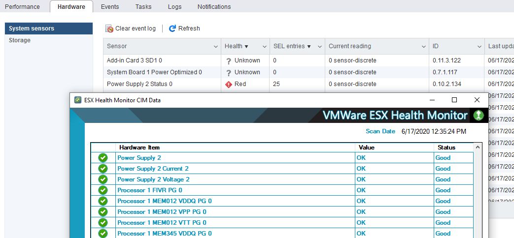

The plugin missed an issue.
VMWare and the iDRAC show the hardware issue. The plugin says it just updated and is Ok and Good.
esx bad.jpg (81.42 KiB) Viewed 20406 times
Re: Failed to Alert
if you run a CIM test on the host what is the returned data, in particular the status code for that item?
See viewtopic.php?f=31&t=5532&sid=a5df00acd ... 0beeb60093
on how to manually test CIM services on host.
It maybe we need to update the status code for the Host type used.
Also is hardware type you have probe set for?

Re: Failed to Alert
Post by RocketMan3360 »
Hey Cubert,
I seem to be having the same problem as Mr. Rat. I ran the probe test you linked and got an Element Op Status=2. Below are my results:
20201007 09:12:37 Found pywbem version 0.10.0
