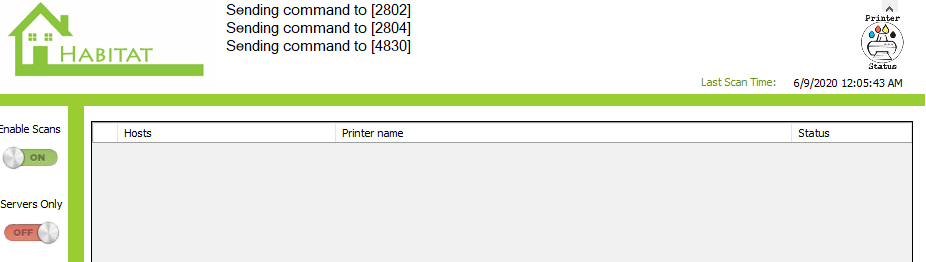

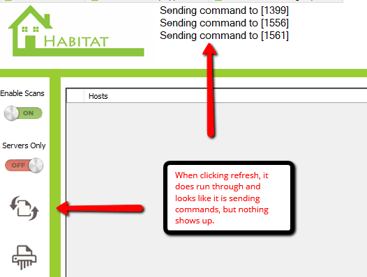

For the Habitat Printer Status tab, we are never able to get any printers to show up for any clients. Other tabs and functions in Habitat are working properly, but we are not able to get Printers to show up. We run the scans and it looks like it is sending commands to the workstations, but nothing appears.
Troubleshooting attempted so far:
- Confirmed the Habitat plugin is installed as directed in the install page. (https://www.plugins4automate.com/pages/ ... to-labtech)

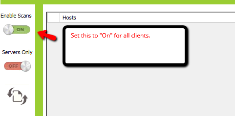

- Went into all clients and set Enable Scans to On.
- Went to Tools-Habitat-Control Center -Printer Status Global Manager. Clicked on refresh to scan the printers and nothing shows up.
Screenshots attached.

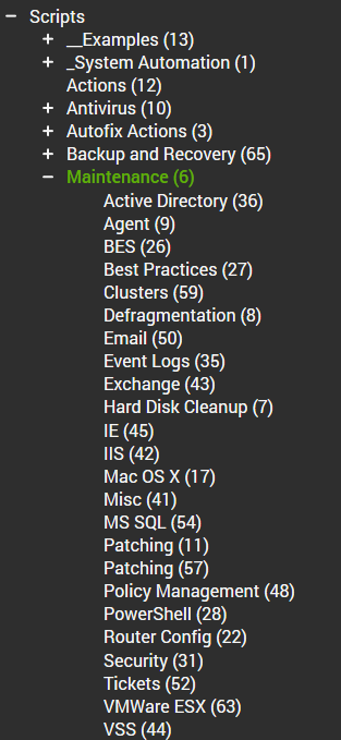

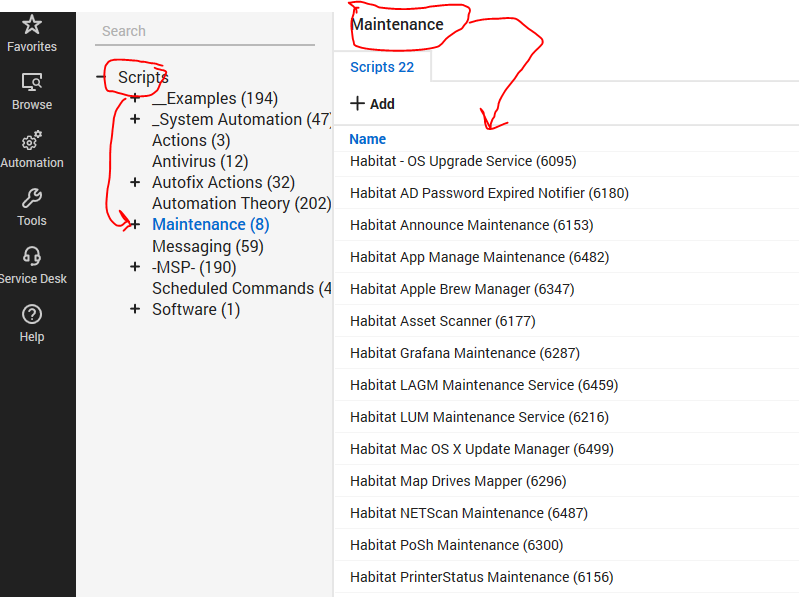

Cubert - Thanks for the reply. I think you are correct about the script. The path Scripts/Maintenance/Habitat Printer Maintenance does not exist. I did restart the DB Agent but nothing appeared. This is what I see when browsing in Scripts/Maintenance
- Habitat.png (60.13 KiB) Viewed 14593 times
Re: Managed Printers not showing up for any clients
Can you confirm or not the following scripts exist? (Higelight Maintenance) but if not there run a search scripts. Your folder # 8 may not be maintenance but some other folder and all scripts would be there then.

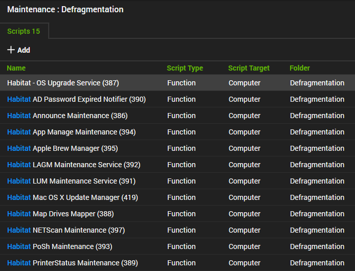

Ok, I was able to find the scripts in the Maintenance\Defragmentation folder. I tried to manually run the Habitat printer script on an agent but they don't appear at all when selecting an agent and going to Scripts\Maintenance\Defragmentation.
There is no option I can find that will allow me to manually schedule a script so that I can see what is in the logs. I tried editing one of the habitat scripts and making it public, but that did not allow it to show up either. The only way I can see them is by going into automation-scripts-view scripts and searching from there.
Ok good that scripts are there, You can move them where you like if needed but by default Defragment is your folder number "8" where everyone else is "maintenance". No harm just means you have to look here for scripts.

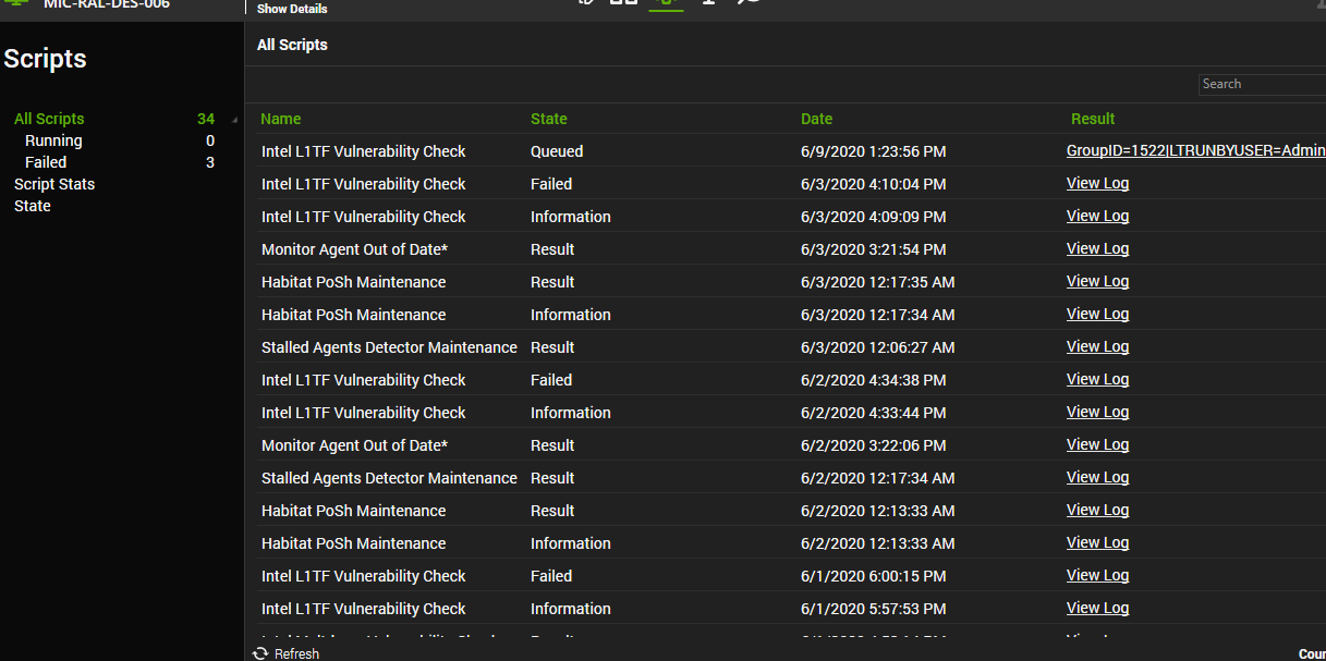

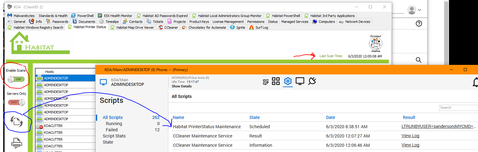

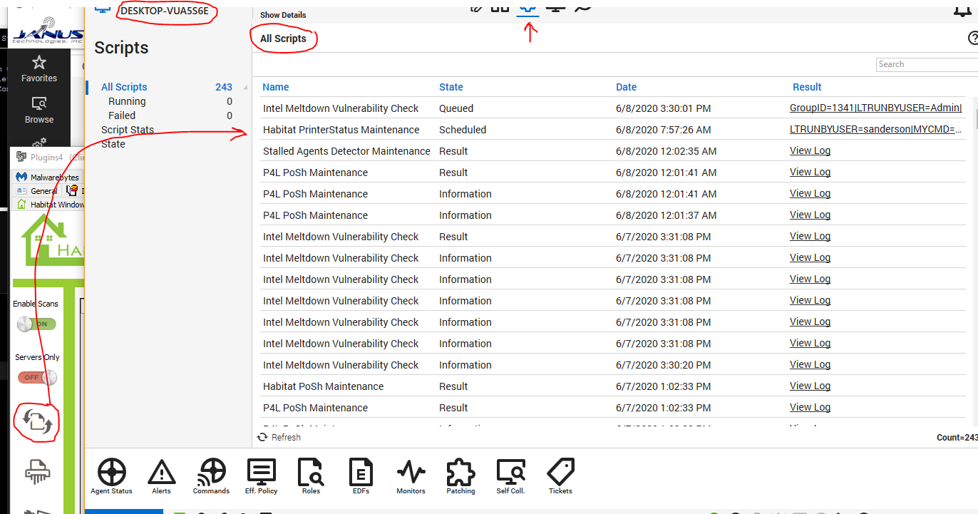

Ok so, to make sure we are both on same page, if you open the printer console under any client and select to rescan client, you see it sending scan to client in the plugin but if you open agent console you do not see in the scripts details, any mention of the Habitat printer maintenance script as see in my image. This happens on all clients?
Can you confirm the current build your on? Should be 1.0.0.44
That is correct. On every client, if I select the option to "rescan" it shows that it is sending commands. If I go to the actual agent and check the scripts section, the Habitat Printer Maintenance Script never shows up. I checked the version and it looks like I am one version behind. Running 1.0.0.43.
As a test, I tried to manually run the script just to see if I could do so. If I select the agent and right click and go to scripts-maintenance-defragmentation none of the Habitat scripts show up as an option. (Maybe that is by design but just wanted to mention it). Thanks for the help so far and for continually reviewing my updates, looking forward to getting this working.
