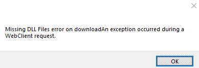

Missing DLL Files error on download
If you get this error when launching the Habitat control center then Habitat is failing to download the Google Drive DLL files to your local LTClient install folder. This is typically a firewall or AV service preventing direct DLL downloads or permissions set on the LTClient Install folder.
Then this error will appear.
To fix this issue:
Either logout and Launch the Automate Console as Administrator once and launch the Habitat Plugin to allow the DLL downloads
-or-
Manually download the files from the links below and place them in the root of the Automate control center install folder on your workstation. Close and relaunch Habitat and error should be gone.
