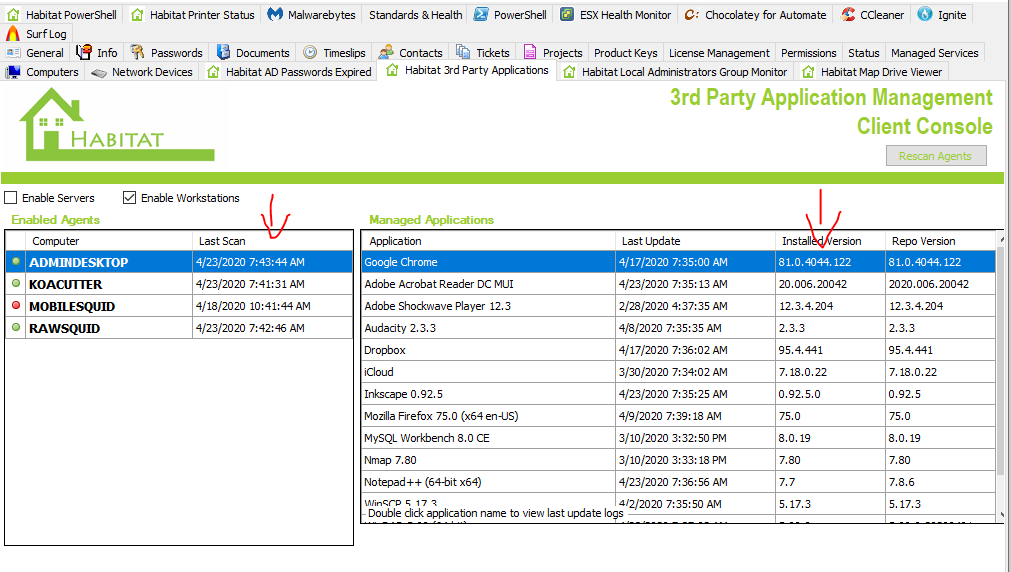

Thanks. So I turned on Enable Workstations at a client site and it scans the machines fine. When I try to push an app update like Google Chrome I get the following if Chocolatey is not installed:
App Manager Running Agent Update Checks for [Google Chrome]...
The system cannot find the path specified
These are the command entries from last night when it tried to update apps on its own:
0|C:\ProgramData\chocolatey\bin\choco.exe-File or Directory Does Not Exist
cmd.exe!!! /c "@CHOCOEXE@ install jre8 -fy"-'CHOCOEXE@' is not recognized as an internal or external command,
operable program or batch file.
cmd.exe!!! /c "@CHOCOEXE@ install googlechrome -fy"-'CHOCOEXE@' is not recognized as an internal or external command,
cmd.exe!!! /c "@CHOCOEXE@ install dropbox -fy"-'CHOCOEXE@' is not recognized as an internal or external command,
-Software Inventories have been Updated.

Re: 3rd party app - chocolatey install
Ok that might be the issue,
If you enable a client and then force a app update before applications show up in app list
then the agent has not had its first scan yet and as such Chocolatey was not yet installed. You need to allow at least 24 hours or so for the agents to start showing last scan dates. Once thats there Chocolatey was installed successfully and a full software scan has happened. Select an agent from the left to see what apps are installer (right)
