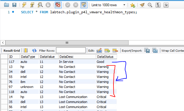

Yes, you can modify the database table that makes that judgement, see image below.
Sort SQL Query on the "DataValue" and look for "12"
Using SQL you can modify the value of the number for each know host type. This should then on next probe change the values of the alarm.

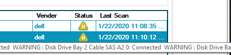

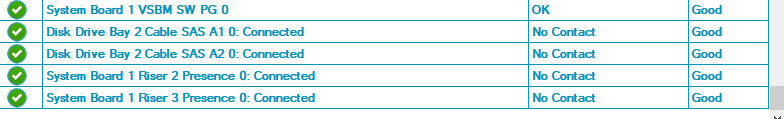

That makes sense but doesn't seem to be making a difference. It was actually already set to good without any intervention on my part, and it showed up fine in the CIM list itself, but on the summary it still shows warning.
Annotation 2020-01-22 114659.png (18.05 KiB) Viewed 34468 times
Annotation 2020-01-22 114553.png (7.96 KiB) Viewed 34468 times
Anything else we can try?

That's a different bean all together. What your seeing there is exactly what the CIM output is, we are not interpreting it at all. When you mouse over the yellow image it will display a tooltip pop up that gives the actual output from the CIM host. If it says warning, Failure or Critical then an image to represent that is displayed.
In the actual CIM data we can control what a status number to status type equals but the raw output from CIM is not modified at all when in summary mode.
Ticketing works off of the CIM data so as long as your OK there then alarms and tickets will not result. You can adjust monitors to only fire when failure or critical is seen which is what I believe the default was.
