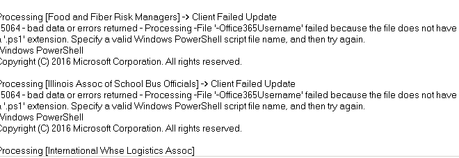

I still have 1 client where it tells me the password is wrong when I know it's not. I even changed it to something more simple.
Now all of a sudden when I run scans from the plugin (on any machine, mine or the LT server), every client comes back client failed update

Posted: Fri Jan 24, 2020 1:49 pm
Did anything change? Automate upgrade or plugin version change?
Re: Issue with database update
Posted: Fri Jan 24, 2020 2:06 pm
by cires316
haven't updated either.
