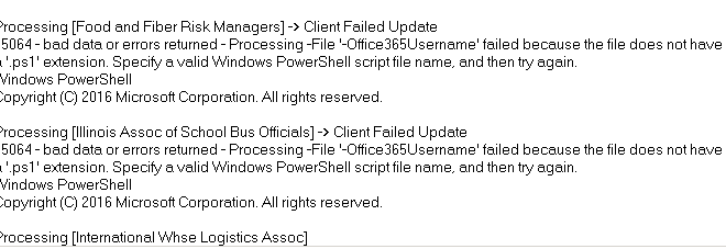

Now all of a sudden when I run scans from the plugin (on any machine, mine or the LT server), every client comes back client failed update
Re: Issue with database update
Did anything change? Automate upgrade or plugin version change?
Post by cires316 »
haven't updated either.
