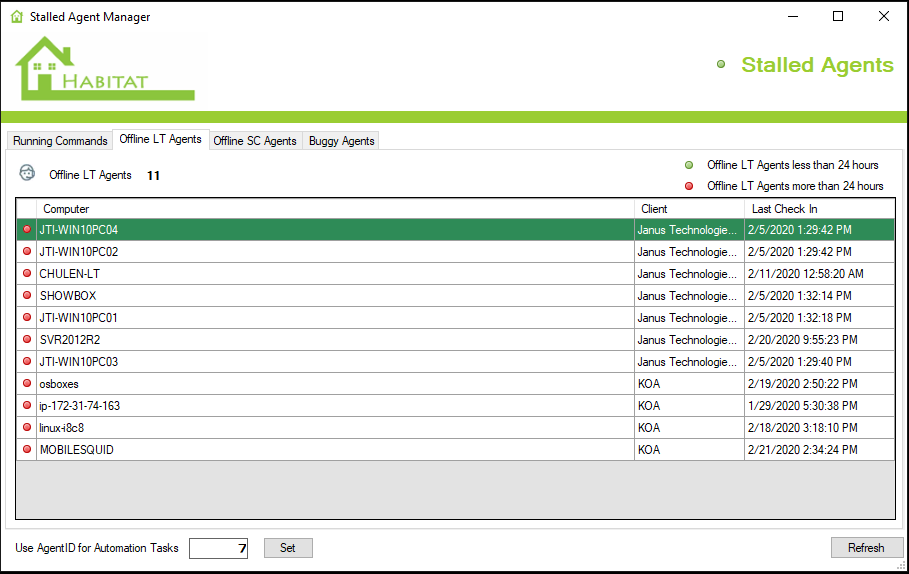

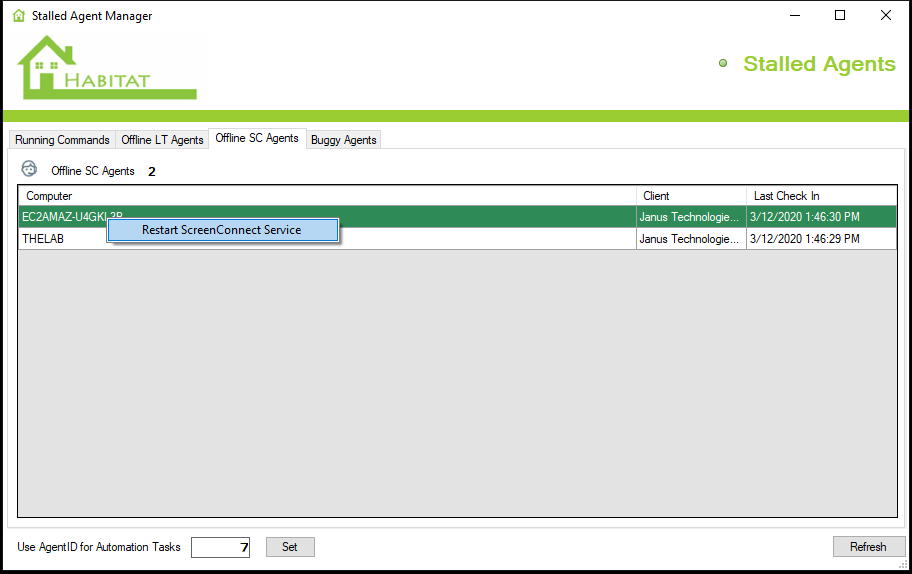

Stalled Agent detector is just that, This tool looks into all agents to see if any agents show running excessive commands or polling the commands, to see if any agent shows offline in either Automate or Screenconnect or shows know active scripting bug issues and displays those agents in plugin. The plugin provides tools to manually clear and or repair a given agent and an automated service to look for offline agents in Automate that are active in Screenconnect and restarts the Automate Services through Screenconnect.
The tool uses 4 main tabs to display possible troubled agents. if you do not see any agents in a view then this is "Great"! that view shows you have no agents with issues.

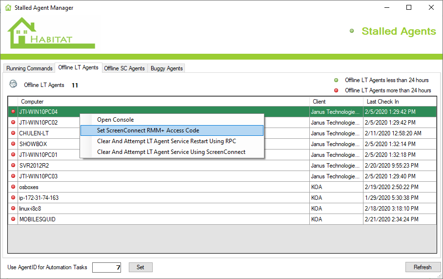

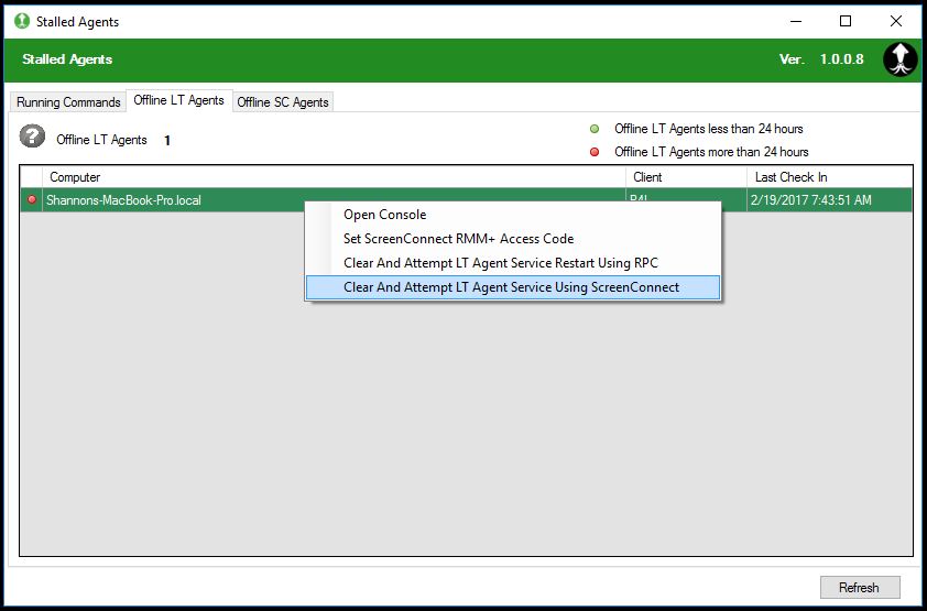

Click into a view then right click an agent in view to pull up menu of actions to perform on agent.
Red dots = agents offline over 24 hours
Green dots = agents offline less than 24 hours.

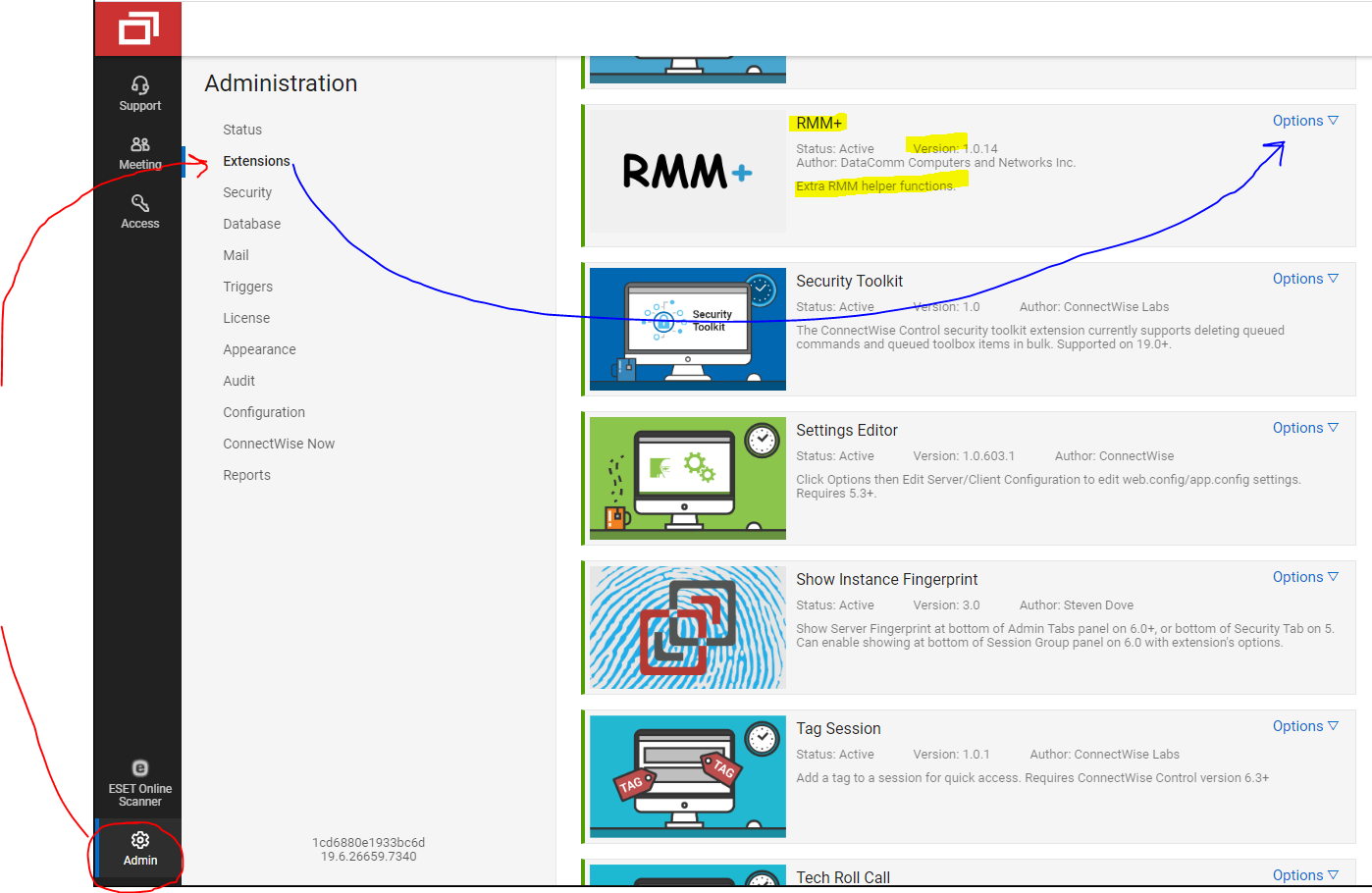

For you to use this feature you will need to first install and configure the RMM+ tool for Screen Connect. This tool can be found in your SrceenConnect web console under "integrations" in the admin panel.

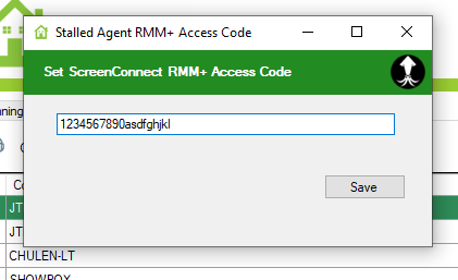

Once installed and enabled and you created your private key for it during the setup process, take that key and update the Habitat stalled Agents tool by selecting an agent and right clicking for menu.
This will open a window to place in your RMM+ security key code.
