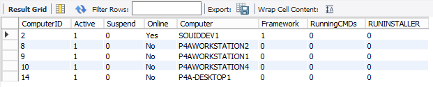

Ok lets look at this issue, We are hitting the "install all agents" function correctly but do not execute any cmds on agents and error that we did not have any data returned from our who in client is able to install query. So lets start with the query and see what we get.
The query below is for client ID 1 so you might need to modify the client ID at the end of the query to repersent the client your working on.
SELECT a.ComputerID, a.Active, a.Suspend, IF(c.LastContact > date_add(now(),interval -5 minute),'Yes','No') As Online, c.Name as Computer, (SELECT count(*) FROM plugin_p4l_chocolatey_computers WHERE Application = 'Chocolatey' AND AppInstalled = '1' AND ComputerID = a.ComputerID) As Framework, (SELECT COUNT(*) FROM commands WHERE Status < 3 and ComputerID = a.ComputerID) As RunningCMDs, (SELECT count(*) FROM plugin_p4l_chocolatey_computers WHERE  Application NOT LIKE 'Chocolatey' AND AppInstalled = '0' AND ComputerID = a.ComputerID) As RUNINSTALLER FROM plugin_p4l_chocolatey_computer_enable a Left Join computers c on a.ComputerID = c.ComputerID WHERE a.ComputerID IN (Select computerID from computers WHERE ClientID IN (SELECT ClientId FROM plugin_p4l_chocolatey_client_enable Where Active = '1') AND OS LIKE '%Microsoft%') AND a.Active = '1' and a.Suspend = '0' AND c.OS NOT LIKE '%Server%' AND c.ClientID ='1' GROUP BY a.computerID
This should return a table full of data about clientID 1

Above we gave you a pretty cool query. This query looks at all enabled agents to see if they are "ready to" do a function like install, update or remove. So when troubleshooting an agent thats does not seem to take instructions use this query to verify the "state" of the agent.
Is it seen as online?
Is it seen as having choco installed?
Is it already running more than 2 commands?
Is it active or suspended?
These all have an effect on whether or not an agent (installs, updates or removes) software.

I've pasted the results from the query you provided with clientid adjusts to 2 here so we can verify that they seem ok, we get a much larger table but I've just included a few relevant computers that I'm using for testing:
"ComputerID" "Active" "Suspend" "Online" "Computer" "Framework" "RunningCMDs" "RUNINSTALLER"
"5201" "1" "0" "Yes" "LAP-TERJEW10" "1" "0" "0"
"5736" "1" "0" "Yes" "IDRIFT-LAP-OLE" "1" "0" "0"
"5791" "1" "0" "Yes" "IDRIFT-WX-OLE" "1" "0" "0"
"5835" "1" "0" "Yes" "ID-LT-81048W5" "1" "0" "0"
As far as I can see they seem to be active and found in your query, not supsended and with framework installed.

Hmmm... In the logs did we ever see during same time frame any logs that showed "Exectuing commands on agent ID "? Should of seen it during the install, update and remove
If we do note see that then we must of failed the test to see if (#1 Are we online and #2 do we have excessive cmds running <2). Either test fails and the command is skipped.
looks like cmds = 1 so thats good
