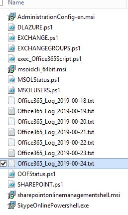

I found the folder that I think these scripts are run from in C:\Windows\Temp\Office365. The contents are shown in the screenshot attached. Is there something missing?

Can you post a picture of the configs window?

Aha! I think that the issue was that Azure needed to be selected even though we don't use Azure-AD for this client.
I now have a list of users!

Awesome, glad to hear that. That is exactly where I was going with the request for config. AZUER is needed on all scans as it sets the company profile up and user lists.
