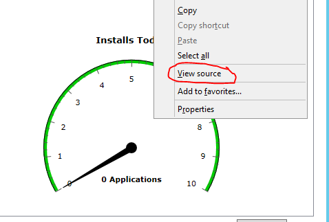

What your seeing there is a Java error from one of the charts on the stats tab.
This is typically due to some type of bad data in the database that is escaping the string we are sending and causing this error.
On the Stats tab, right click over a chart will bring up a menu to allow you to view the raw HTML. You can review the data being returned by the Chart API to create chart.
If no charts are visible the error windows should allow you to see the raw HTML. By selecting the "URL" in the error code window, copying that to a browser and running it directly in the browser will reproduce the same error but also return the JAVA code that failed so you can see the data in the HTML and decide what data and where it blew up.
Then when you have the "column" of data that caused the error (something with uncommon char in it). Remove that data from the database and issue will resolve. This is typically some comma or semicolon some where in the data that is escaping the java code before it has completed.

Here is the raw html code:
<!DOCTYPE HTML PUBLIC "-//W3C//DTD HTML 4.01//EN" "http://www.w3.org/TR/html4/strict.dtd"> ... head><meta http-equiv="Content-Type" content="text/html; charset=utf-8"><title>Squid Charts API</title><link rel="stylesheet" href="style.css" type="text/css"> <script src="./amcharts/amcharts.js" type="text/javascript"></script><script src="./amcharts/gauge.js" type="text/javascript"></script> <script type="text/javascript">
var chart;
var arrow;
var axis;
AmCharts.ready(function () {
// create angular gauge
chart = new AmCharts.AmAngularGauge();
chart.addTitle("Installs Today");
// create axis
axis = new AmCharts.GaugeAxis();
axis.startValue = 0;
axis.axisThickness = 1;
axis.valueInterval = 1;
axis.endValue = 10;
// color bands
var band1 = new AmCharts.GaugeBand();
band1.startValue = 0;
band1.endValue = 10;
band1.color = "#00CC00";
var band2 = new AmCharts.GaugeBand();
band2.startValue = 0;
band2.endValue = 0;
band2.color = "#00CC00";
var band3 = new AmCharts.GaugeBand();
band3.startValue = 0;
band3.endValue = 0;
band3.color = "#00CC00";
band3.innerRadius = "95%";
axis.bands = [band1, band2, band3];
// bottom text
axis.bottomTextYOffset = -20;
axis.setBottomText("Applications");
chart.addAxis(axis);
// gauge arrow
arrow = new AmCharts.GaugeArrow();
chart.addArrow(arrow);
chart.write("chartdiv");
// change value every 2 seconds
setInterval(randomValue, 2000);
// set random value
function randomValue() {
// var value = Math.round(Math.random() * 200);
arrow.setValue(0);
axis.setBottomText(0 + " Applications");
</script>
</head><body><div id="chartdiv" style="width: 100%; height:270px;"></div></body></html>

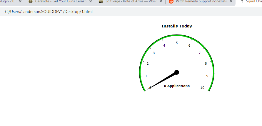

Re: Error with chocolatey plugin 2.0.1.90
Interesting.
If I load it this is what I get.
Here is the code again
<link rel="stylesheet" href="http://charts.squidworks.net/style.css" type="text/css">
<script src="http://charts.squidworks.net/amcharts/amcharts.js" type="text/javascript"></script>
<script src="http://charts.squidworks.net/amcharts/gauge.js" type="text/javascript"></script>
var chart;
var arrow;
var axis;
// create axis
axis.endValue = 10;
// color bands
band2.endValue = 0;
band3.endValue = 0;
// bottom text
// gauge arrow
// set random value
arrow.setValue(0);
</script>
No what I am seeing for error is not a error indeed. It actually works for me as intended when I cut and paste your code.
