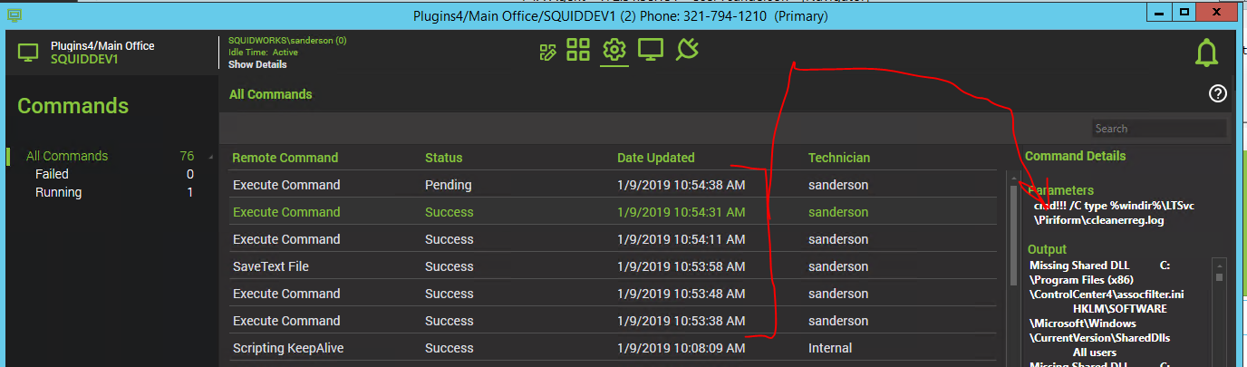

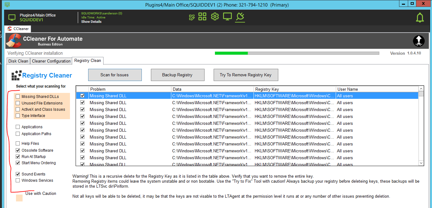

There is one way to help reduce the time to scan, Removing selections will reduce the scan time and may allow scans to complete in a timely fashion. See images below where we turned off most of the scan options then ran a scan. Scan took 2 minutes to complete and data was displayed as expected. Depending on the size of a registry this time value will change. Some settings may work fine on one system and not another based on the sizes.
The scan started at 10:53 and ended at 10:54 with data
