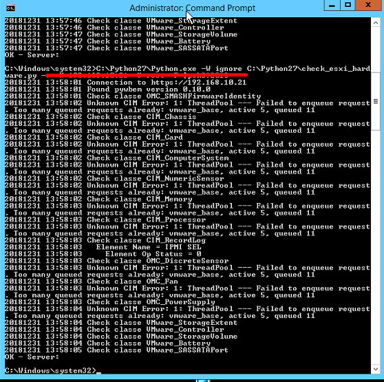

The drive is indeed green lighted, I had to replace it immediately as it was in a failure state for close to a month. I couldn't take the risk much longer, sorry! I used the test command linked and received a lot of feedback about an Unknown CIM error. Attached is the screenshot for review. Let me know if you wish for me to continue with your instructions, thanks for your help!
- ScreenConnect.WindowsClient_2018-12-31_13-58-34.png (158.36 KiB) Viewed 20028 times
Re: Esxi Health Monitor: Host has bad drive, Monitor did not alert
Ok What version of ESX are you on and has this ESX server been rebooted recently?
We seen fairly often that ESX stops responding to CIM requests or dumps no data and it turns out something is a miss on the ESX host. A fresh reboot tends to resolve the issues.
