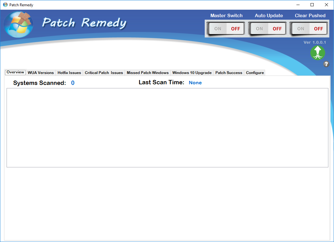

I have recently been trying to get PatchRemedy working properly but have unfortunately been running into issues no matter what I try.
I have followed the steps from this post:
viewtopic.php?f=7&t=5522
I reached the stage where I scheduled the scan time interval and then the clients to scan.
I then hit the master switch to On and then left the plugin window open, about a minute or so later it closed.
I reopened the Patch Remedy plugin and it shows no configuration, the master switch is Off and the version shows as ver 1.0.0.1
If I close LT, delete the DLL from C:\ProgramData\Labtech Plugins\LTSERVERNAME and reopen LT it will download the file again from the server. I reopen the plugin and it shows the correct version but the master switch is on.
Once again if I close the plugin only and reopen it, master switch is off and version is back to 1.0.0.1
Screenshot attached to this post.
To recap I have run the following:
1) Disable PatchRemedy in plugin manager
2) Deleted plugin
3) Restarted DB agent
4) Closed LT
5) Dropped all plugin_sw_patchremedy tables
6) Removed PatchRemedy DLL files from C:\ProgramData\Labtech Plugins\LTSERVERNAME
7) Downloaded latest version from https://delivery.shopifyapps.com/-/fac3 ... 8ecf28bd31
8) Installed plugin
9) Enabled plugin
10) Restarted DB agent when prompted
11) Closed and reopened LT (tested both opening as myself and run as admin)
12) Launched plugin
13) Set scan interval
14) Select all customers
15) Hit save
16) Toggled master switch to On
17) Reopen of plugin clears settings and shows incorrect version
Odd plugin behaviour after reinstall with complete cleanup
- patchremedyissue.png (97.68 KiB) Viewed 17237 times

Re: Odd plugin behaviour after reinstall with complete cleanup
Hi Cubert,
I've come in this morning and these are the steps and results given:
1. Opened LT fresh (not previously open)
2. Opened PatchRemedy plugin
3. Version # is correct
4. All switches are off
5. No popup, license valid through to 8th Jan 2019
6. Turned ON master switch
7. Closed PatchRemedy plugin
8. Reopened PatchRemedy
9. Master switch OFF, all config gone.
10. Version showing as 1.0.0.1
11. Configure Tab shows license expired
Any ideas on how to move forward?
Hi Cubert,
I've tested this on multiple other machines and we have the same behaviour.
I checked the LT server logs, both provided by the LT Server software and within the LT Server Event Logs.
There is nothing being logged that would be causing this issue in either locations.
I even reached out to LT support and they ran their toolkit over our server and made some changes and optimised things but we are still in the same boat.
Not too sure where to go from here..
Edit:
I found some error logs, it happens on multiple machines:
Dispatcher Exception: Could not load file or assembly 'DevExpress.XtraCharts.v12.2, Version=12.2.17.0, Culture=neutral, PublicKeyToken=b88d1754d700e49a' or one of its dependencies. The system cannot find the file specified.
Hi Cubert,
I copied the files into the \LabTech Client\ folder and overwrote the files there.
When trying to launch the plugin event viewer shows:
Dispatcher Exception: Could not load file or assembly 'DevExpress.XtraCharts.v12.2, Version=12.2.17.0, Culture=neutral, PublicKeyToken=b88d1754d700e49a' or one of its dependencies. The module was expected to contain an assembly manifest.
The module was expected to contain an assembly manifest. (Exception from HRESULT: 0x80131018)

I then downloaded the DevExpress installer and tried to install. It errored showing:
Cannot register types for eXpressAppFramework assembly
After googling this error DevExpress said this shows if VS C++ 2005 is missing or has errors. I can see this installed in my Programs and Features but I found an express edition and installed this.
I checked the plugin, still having the same issues so I reran the DevExpress installation in a repair install, we get the same error: Cannot register types for eXpressAppFramework assembly
I then found VC++ 2005 x86 and x64 Redistributable packages and installed them both from here:
https://www.microsoft.com/en-au/downloa ... px?id=3387
https://www.microsoft.com/en-AU/downloa ... x?id=21254
I uninstalled DevExpress and reinstalled it, we get the same error.
I decided to test on another machine that had never previously had LT installed on it.
Prior to installing I can see this only has VSC++ 2008 and 2015 redistributables.
While installing LT installs the other VC++ redistributables, 2005 (both x86 and x64) and 2013 x86.
I logged in and launched the control centre - This has pulled the DevExpress files into the \LabTech Client\ folder.
I've gone to run the PatchRemedy plugin and Event Viewer shows:
Stacktrace:
at PatchRemedy.ToolsForm.InitializeComponent()
at PatchRemedy.ToolsForm..ctor(IControlCenter objClient)
at PatchRemedy.clsMenus.ShowApprovalForm(Object sender, EventArgs e)
at System.Windows.Forms.MenuItem.OnClick(EventArgs e)
at System.Windows.Forms.MenuItem.PerformClick()
at LTClient.ControlCenter.ViewModels.ControlCenterSideNavViewModel.WinFormItemSupportCommand.Execute(Object parameter)
at LabTechPresentation.Controls.CategoryExplorer.CategoryExplorer.TreeViewItem_MouseLeftButtonUp(Object sender, MouseEventArgs e)
at System.Windows.Input.MouseButtonEventArgs.InvokeEventHandler(Delegate genericHandler, Object genericTarget)
at System.Windows.RoutedEventArgs.InvokeHandler(Delegate handler, Object target)
at System.Windows.RoutedEventHandlerInfo.InvokeHandler(Object target, RoutedEventArgs routedEventArgs)
at System.Windows.EventRoute.InvokeHandlersImpl(Object source, RoutedEventArgs args, Boolean reRaised)
at System.Windows.UIElement.ReRaiseEventAs(DependencyObject sender, RoutedEventArgs args, RoutedEvent newEvent)
at System.Windows.UIElement.OnMouseUpThunk(Object sender, MouseButtonEventArgs e)
at System.Windows.UIElement.RaiseEventImpl(DependencyObject sender, RoutedEventArgs args)
at System.Windows.UIElement.RaiseTrustedEvent(RoutedEventArgs args)
at System.Windows.UIElement.RaiseEvent(RoutedEventArgs args, Boolean trusted)
at System.Windows.Input.InputManager.ProcessStagingArea()
at System.Windows.Input.InputManager.ProcessInput(InputEventArgs input)
at System.Windows.Input.InputProviderSite.ReportInput(InputReport inputReport)
at System.Windows.Interop.HwndMouseInputProvider.ReportInput(IntPtr hwnd, InputMode mode, Int32 timestamp, RawMouseActions actions, Int32 x, Int32 y, Int32 wheel)
at System.Windows.Interop.HwndMouseInputProvider.FilterMessage(IntPtr hwnd, WindowMessage msg, IntPtr wParam, IntPtr lParam, Boolean& handled)
at System.Windows.Interop.HwndSource.InputFilterMessage(IntPtr hwnd, Int32 msg, IntPtr wParam, IntPtr lParam, Boolean& handled)
at MS.Win32.HwndWrapper.WndProc(IntPtr hwnd, Int32 msg, IntPtr wParam, IntPtr lParam, Boolean& handled)
at MS.Win32.HwndSubclass.DispatcherCallbackOperation(Object o)
at System.Windows.Threading.ExceptionWrapper.InternalRealCall(Delegate callback, Object args, Int32 numArgs)
at System.Windows.Threading.ExceptionWrapper.TryCatchWhen(Object source, Delegate callback, Object args, Int32 numArgs, Delegate catchHandler)
v120.473
The plugin did not show either - Testing any other plugins these show.
I didn't mention this earlier as I thought it was just a glitch which wasn't too much of a concern but I will mention it now.
If you follow these steps:
1) Open LT client
2) Attempt to launch PatchRemedy plugin - Error shows in Event Viewer (as shown above) and the plugin doesn't pop up
3) Open another plugin - Works fine
4) Go back to open PatchRemedy - Opens fine
5) Close and reopen PatchRemedy - Version resets to 1.0.0.1 and no config
You can repeat the same steps on any machine and it has the same result.
The latest machine we tested on does not have AV, for the machines we tested on that did have AV we scoured the logs and there is nothing.
On the new system without AV, I tried installing the DevExpress in trial installation - We have the same error of Cannot register types for eXpressAppFramework assembly.
So we have several computers, physical and virtual, some with and some without AV, in different locations and different operating systems all with the same issues.
Any idea on where to go from here ?
Stacktrace:
v120.473
1) Open LT client
