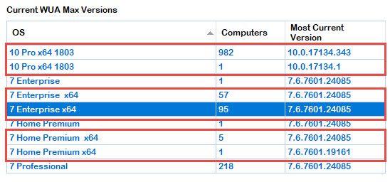

I'm seeing the same thing. The 2 - 10 pro x64 1803 have different Max WUA versions.
And the other duplicate OS's with the extra space. I have purged the maxWUA table and relaunched the plugin and the issue remains.

The MAX WUA table is rebuilt every time you open the plugin so the issue is not the maxwua but the WUA table having OS's that have extra spaces in them. So when we build the max wua data from WUA we get variances based on actual OS fields which are not fully consistent inside LabTech.
We use the "%OS% variable in the scripting to grab OS name. LabTech presents OSes with the extra space in them.
I am looking in to a new PS function to run against the OS variable to remove extra junk from them. Lets see if that helps the situation some.

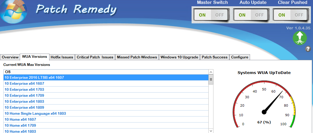

Thanks for the update. I noticed this yesterday on .34 as well no change on .35
There are now no wua versions associated with the OS in the top portion. As well as duplicates and spaces(screenshot) Please advise.

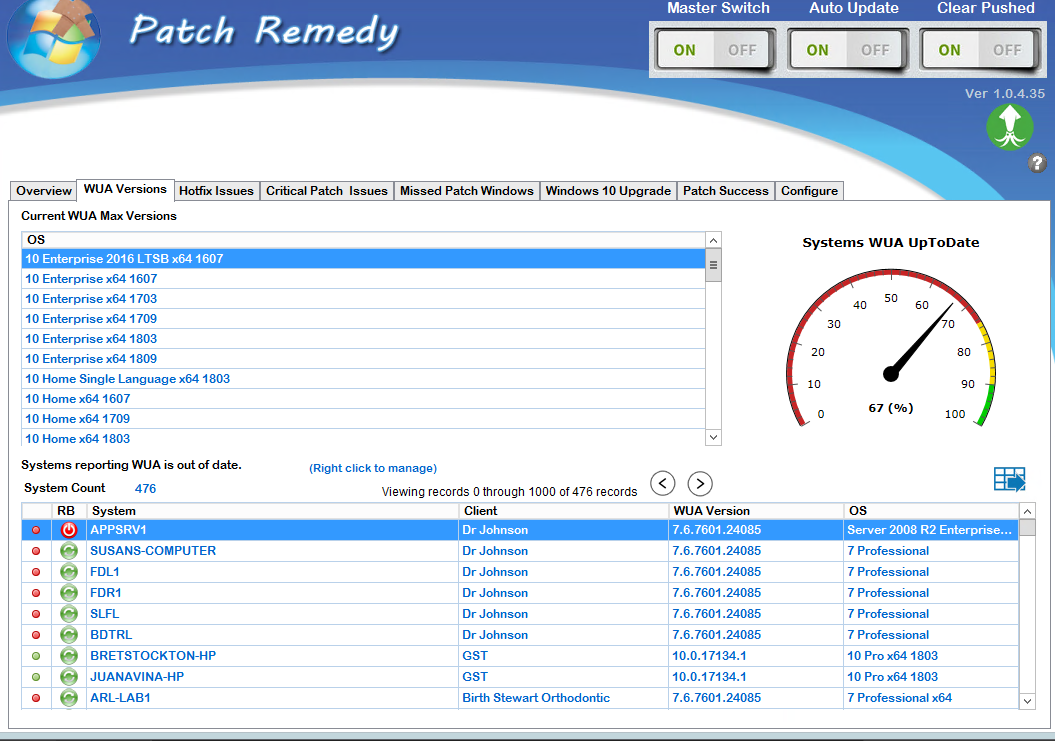

I ran the sql statement to truncate the tables. However, our system shows it to be 'plugin_' not 'plugins_'
So i had to adjust the sql statement for that.
We have PR configured to scan every 2 hours. I ran the slq statement mid afternoon and checked it this morning. No change. See screenshot.
