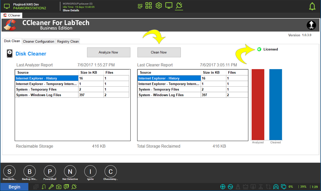

Re: CCleaner Plugin Fails to Analyze or Clean
Try running a scan manually, does it complete as it should? If it does then it will during automation. Click the squid logo to get help documentation. You can select Analyze Now without a license.
