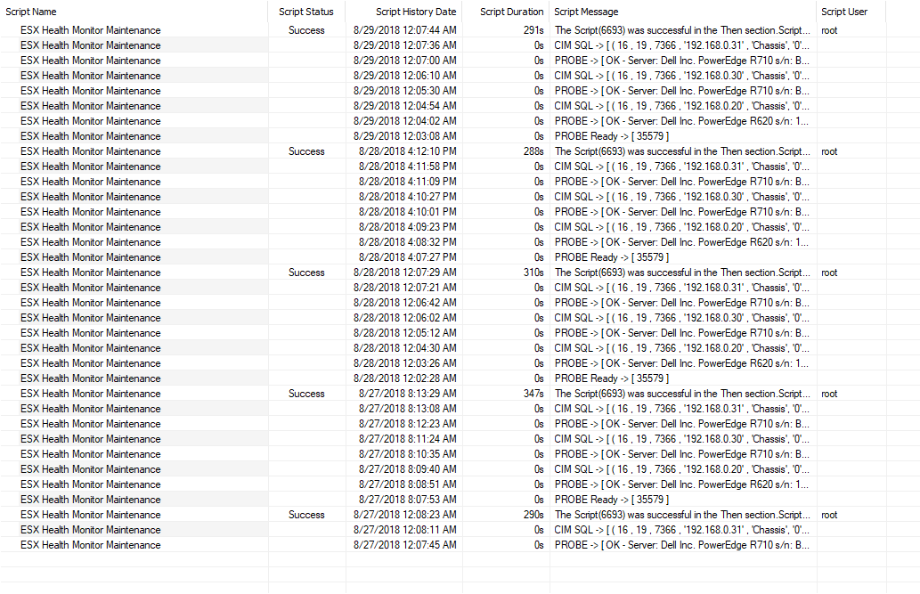

Shannon, this is Jason Hand. I did more research and it looks like when we see this it happens to all of our ESX probe servers and the logs show that the ESX health monitor maintenance script never ran on any of them. It is like the script was never scheduled after the last reported run. Any idea how to get it running again? We have it set to probe every 8 hours and as you can see from the script log on one of our probe servers it hasn't run since 8/29/18 at midnight so nothing for more than 39 hours.
