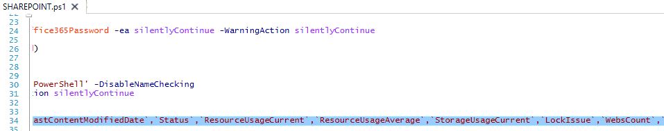

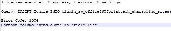

No Sharepoint data is being collected due to a bug in the INSERT command. I tried running the Debug output manually through SQLYog and found the typo; changing it to WebCount fixed the query and it inserted the data correctly.
bug-Sharepoint powershell-Webscount query result.JPG (21.51 KiB) Viewed 40288 times
bug-Sharepoint powershell-Webscount instead of Webcount.JPG (28.72 KiB) Viewed 40288 times

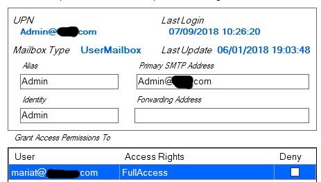

GUI Bug -- the mariat@ user is not from this client, but keeps showing up on mailboxes that do not have any rights granted to other users.
bug-phantom mailbox permissions.JPG (40.23 KiB) Viewed 40288 times

Upon further review of the Sharepoint script, the "typo" of WebsCount looks like it's actually with the database table creation, as everywhere else in the script the variables are also WebsCount but the column in the database was created as WebCount. I tested renaming the column in the database to WebsCount, and I can copy and paste the debug output into SQLyog and the queries execute successfully, but running the client scan is still not populating the information.
Re: 2.0.0.74 - Issues with powershell scripts
Awesome post!
Could ask for a better bug find and self fix. I have reviewed all the reported issues and have now updated Office365 to 2.0.0.75 which should fix all the issues reported.
You will need to self "DROP TABLE plugin_sw_office365forlabtech_sharepoint_sites" followed by a DBagent restart for the new table to be created with correct column for those who haven't edited the table.
