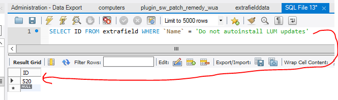

If you just look for the EDF ID does it produce one?
SELECT ID FROM extrafield WHERE `Name` = 'Do not autoinstall LUM updates'

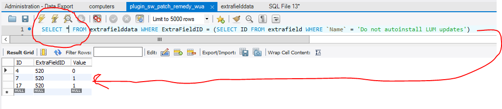

If you change the count (*) to just SELECT * and remove the "and value= 0 and ID = 'xxx'" from the SQL statment you should get all linux boxes produced and their current settings.
SELECT * FROM extrafielddata WHERE ExtraFieldID = (SELECT ID FROM extrafield WHERE `Name` = 'Do not autoinstall LUM updates')

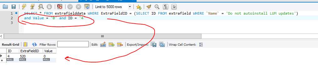

#3

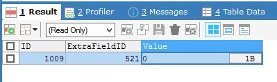

If you add back in the Value and ID tests into SQL do you get a single agent listed?
and Value = '0' and ID = '4'

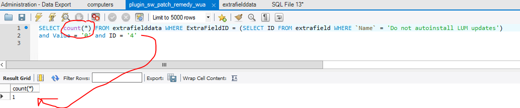

And lastly, #4

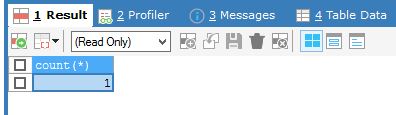

If you put all the code back together, does it produce a count of 0 or 1. We are looking to get a count not a value. By getting a count over a value, the SQL will never "fail" because of data or an entry not being there. we will always no matter what either get a 0 or a 1. We want a 1 to proceed with update. Toggle all agents in edf you want updating to a '0'
SELECT count(*) FROM extrafielddata WHERE ExtraFieldID = (SELECT ID FROM extrafield WHERE `Name` = 'Do not autoinstall LUM updates')

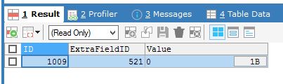

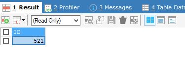

Here are my results (using the same test linux machine ID 1009) from the SQL queries.
#1
#2
#3

Re: LUM Not autoinstalling
Post by dcancela »
#4
I can also see the value changing when i check and uncheck the box. (From 0 to 1)
I have noticed though that after a Labtech server reboot or patch (or something else?) the value gets reset to blank. So i have to check and uncheck it again to show up. Maybe that was the issue, i am not sure. But i am resetting them again just in case and i will let it run again and see if it works.
