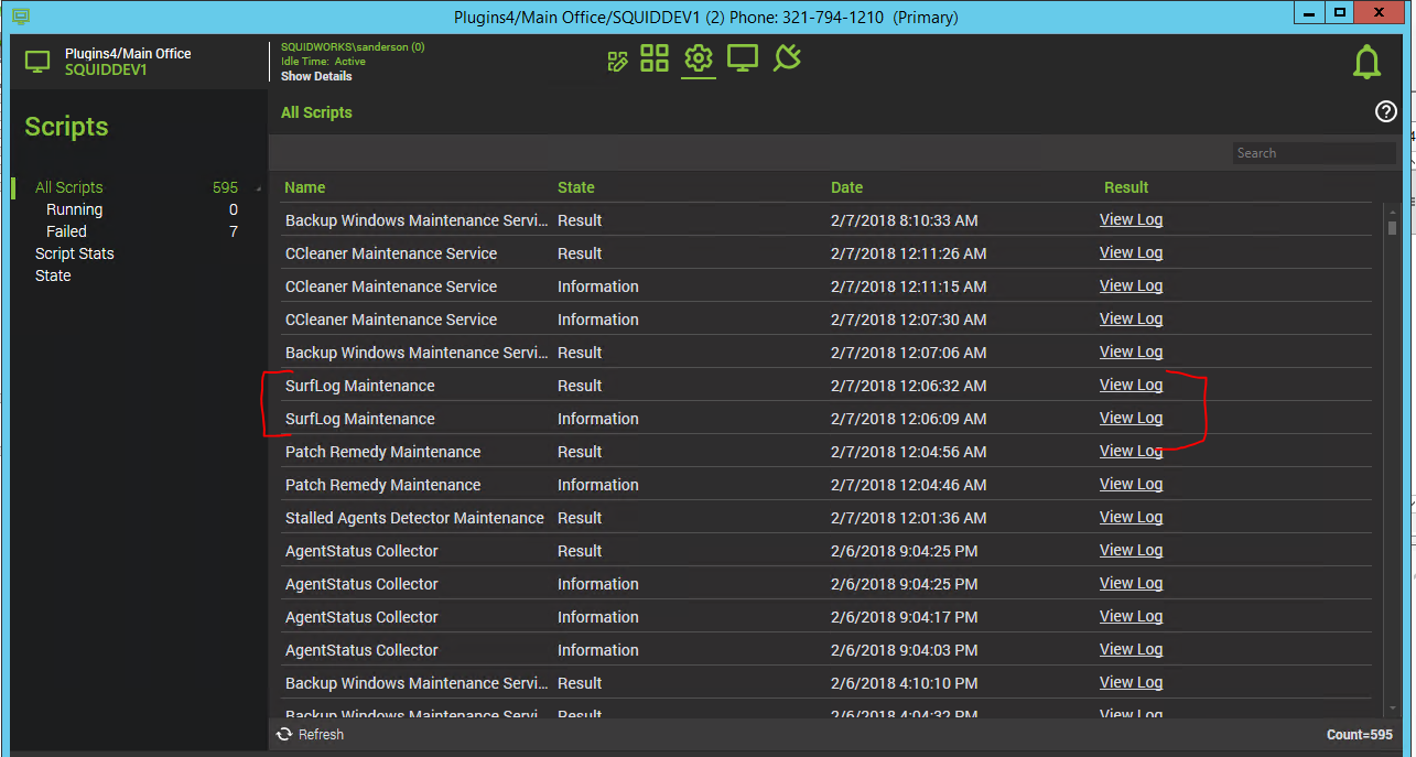

First thing is to verify that Surflog maintenance script is being scheduled and completing on the system in question. Verify this by looking at the Scripts and Commands tabs of the computer console in Labtech during that time span.
