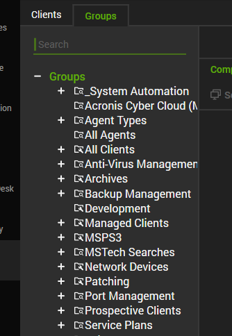

Actually, I think I see the problem with the above issues... the search groups are not there.
PL-MSTech
Posts: 75
3
Post by PL-MSTech »
Automate got an update today... installed the latest version of C4A to 3.6.0.3
Still no search groups... how do we get this installed correctly?
