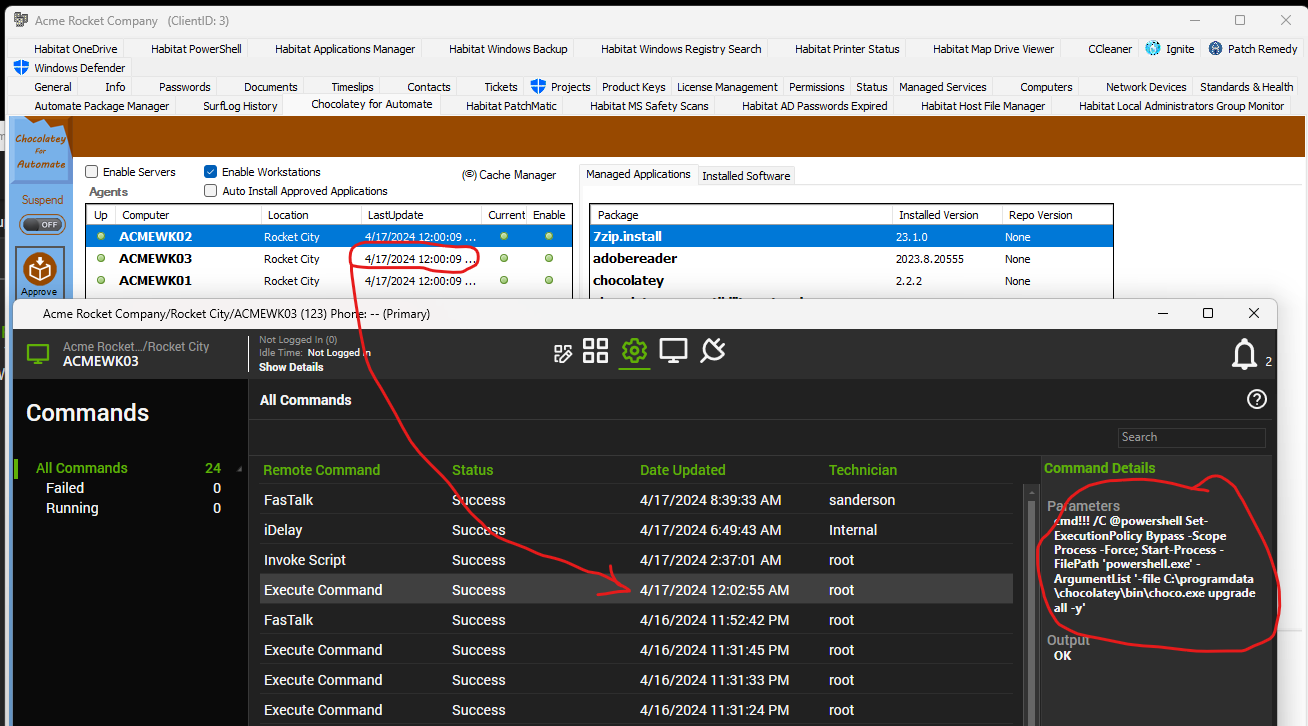

Re: C4A 3.6 updates/changes
Posted: Wed Apr 17, 2024 1:15 pm
Here is what should be happening. In my case here, this client is set to daily updates which automatically happen at 12 AM daily. We do not schedule a script to update agents, we actually send down a direct command to execute on the agent. This command is crafted to force the update process into the Windows background and releases the LTagent service from waiting on command to finish. This is done this way as a large set of applications being updated could exceed the LT command timeout limit of 5 minutes.
Screenshot 2024-04-17 084957.png (161 KiB) Viewed 122259 times
There are some requirements that must be met before command is sent.
#1 (ChocoApproved = 1 And ChocoInstalled = 1) Chocolatey framework must show as installed in database and that agent is enabled for Chocolatey
#2 (Agent Online = 1) Agent must also be online at the time of command.
Typically #2 is your issue, If your Windows desktops goes to sleep at night then they will be skipped during the 12 am update call.

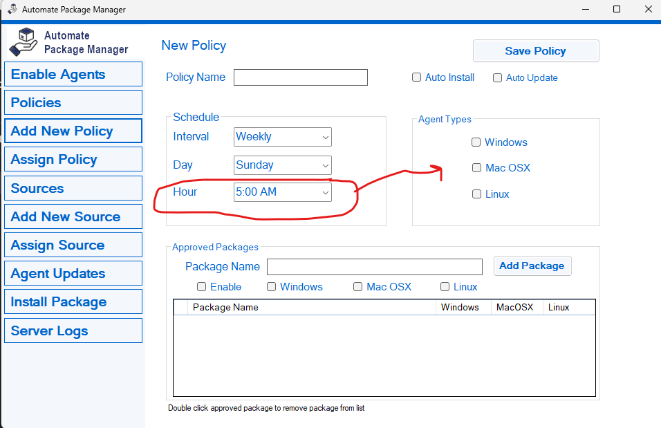

Not to bait and switch you, but in our latest plugin, Automate Package Manager, we addressed this limitation in scheduling by allowing you to also manage the time of day we push out updates.
In APM, you not only get to manage Chocolatey but Homebrew, Apt (Ubuntu), Yum (RedHat), and Zypper (openSUSE) all in the same style and views seamlessly. We also now deploy policies for software installs and updates allowing you to centralize the management of policies across the RMM environment.
Improved design, does more, more efficient, policy driven and costs the same as C4A.
The nice thing is, if you don't have a need for Mac and Linux software management then just don't create policies with Mac or Linux selected in policies. You Mac and Linux agents will remain untouched by APM.

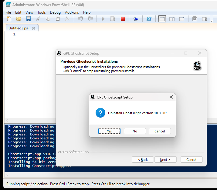

Posted: Thu Apr 18, 2024 1:34 pm
I just happen to have an example issues here I came across on my own system when responding to your post. I wanted to validate the command syntax so I ran it in a terminal on my own PC and the upgrade all was going along just fine till this popped up on my desktop.
Screenshot 2024-04-18 092435.png (74.4 KiB) Viewed 122211 times
In the middle of my upgrade all execution, I get a dialog box to uninstall a previous version of GhostScript before it can continue. If no one accepts this then this just sits there in limbo. If it was launched from Automate as a terminal command, there in no desktop to pop in to.
This is a direct result of the package maintainers failure to create a headless uninstaller as part of package manifest. Instead the maintainer just calls the executables uninstaller executable directly with out switched for silent uninstalls.
A good note that with Chocolatey, Not all packages built the same and may cause unexpected results.

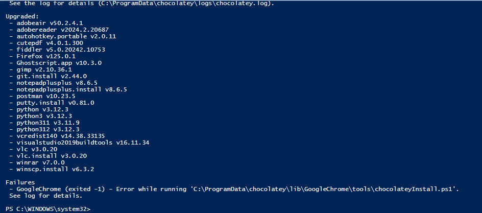

Posted: Thu Apr 18, 2024 2:06 pm
I accepted the Ghostscript uninstall and allowed the manual update to complete.
Upon completion I received this return:
Screenshot 2024-04-18 094814.png (37.05 KiB) Viewed 122209 times
Google failed to update, Tells me to go see logs on why.

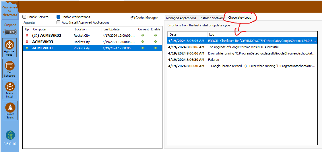

Posted: Fri Apr 19, 2024 9:27 pm
I have released build 3.6.0.10 that adds 2 new features to Chocolatey.
#1 Added Error logging retrieve to the Chocolatey scanner script. It will look for and parse out the chocolatey.log file looking for Errors, If it finds any errors in log it will capture the error and date and save it to Automate.
It will then remove the log file. Next scan will repeat the log scan, if new file appears with errors in it the current logs will be replaced with the new logs.
This means you could have potential logs on any update or install execution. If errors exits we will import them. You will only ever see Error logs and only the latest errors.
#2 We added a Chocolatey Source reset to the Scanner script. If agents had either sources or UNC enabled, then disables them both, the scanner script on next scan will auto reset the default repo back to chocolatey public repo.
Auto Updates should happen tonight!
Here is new log tab under agent views:
Screenshot 2024-04-19 122244.png (56.91 KiB) Viewed 122181 times
