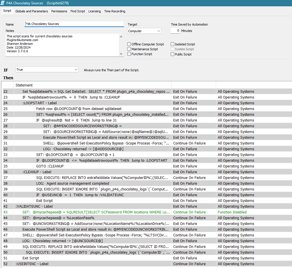

While looking for your script lines listed in log, we started testing some of our UNC code. We found an issue in our environment. It looks like sometime during the last several months ConnectWise putout an update that has broken the UNC functionality we originaly used to capture usernames and passwords with.
The original problem we faced when plugin 3.0 was created, was that we did not get consistant passwords from %locationpass% across Labtech/Automate hosts. Many times we would receive <HiddenPassword> or blank as a return when using.
At the time, Automate stored these values unencrypted in the database in the the `Locations` table as SCPassword for the locationID.
We used a simple query to obtain this value in Automate script by query which worked for years.
SELECT SCPassword FROM locations WHERE LocationID = '%locationid%' and ClientID ='%clientid%'
However during our resent testing, we found that we are now getting an encrypted value for this query (Kudos for them!). We also retested capturing the values of %locationpass% and we are now able to return this value in our environment.
A quick fix to this issus is to disable line 43 and add a new line (44) that sets a contant value of @mycachepass@ = %locationpass%. This will allow the password to be correctly generated and added to the @UNCWorkingSTRING@
