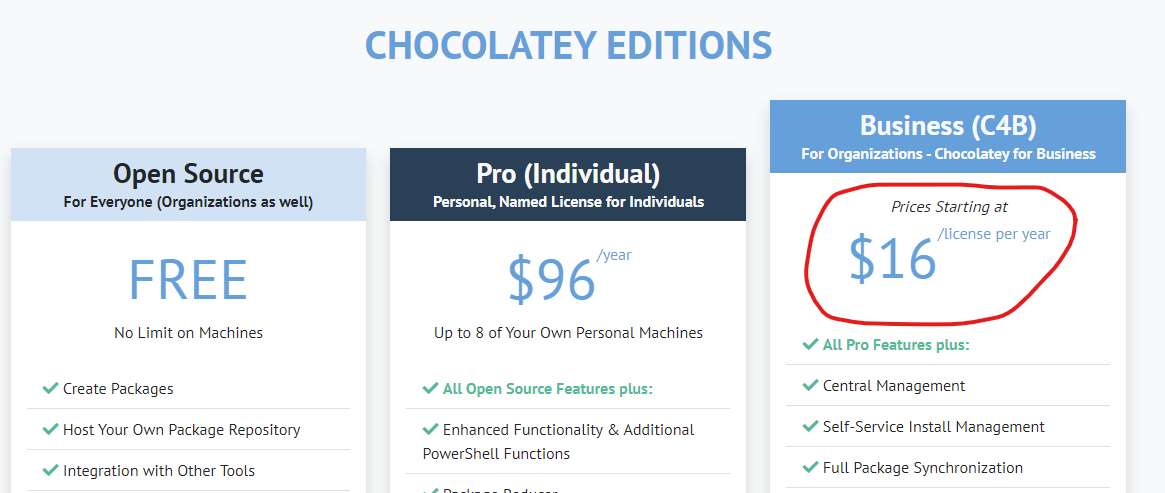

The other option is to purchase a license for each agent you want to run standalone, In the plugin we provide a license importer that will take the XML license code they give you and transfers that to all agents to pre license them so that they do not trigger the throttles and blocks that multiple unlicensed agents will do from a single location. Then you can forgo any caching in this case.
Here is that fee per agent. If you use caching for a location this is not required, only if you want to run a location as standalone that has lots of agents and you want those agents to actually complete the installs and updates without blocks and bands.
Screenshot 2022-07-14 092807.png (67.69 KiB) Viewed 21402 times
