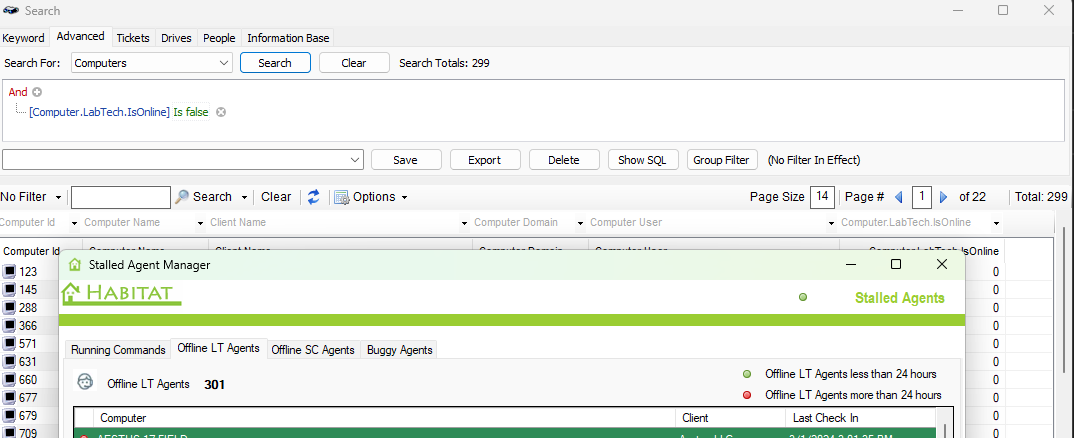

The "Offline Computers" dataview shows 253 offline computers.
The Stalled Agent Manager shows 257 "Offline" LT Agents. Since these are very similar numbers, I am let to believe they are very similar lists, perhaps with the Stalled Agent Manager being more up to date as the dataview is relying on the built-in inventory polling.
However, according to your post it seems that the Stalled Agent Manager should only be showing machines that are ONLINE in Screenconnect despite being offline in Labtech. Thus indicating a problem with the agent, as opposed to the computer simply being offline.

I do not see any further updates on this issue and the behavior seems to remain unchanged so I am a bit confused as to which way it is supposed to work. Unfortunately if this is simply a view of all offline agents then it seems to have limited utility as the hope was to identify agents that are potentially online despite not reporting in Labtech.
Thank you for your response!

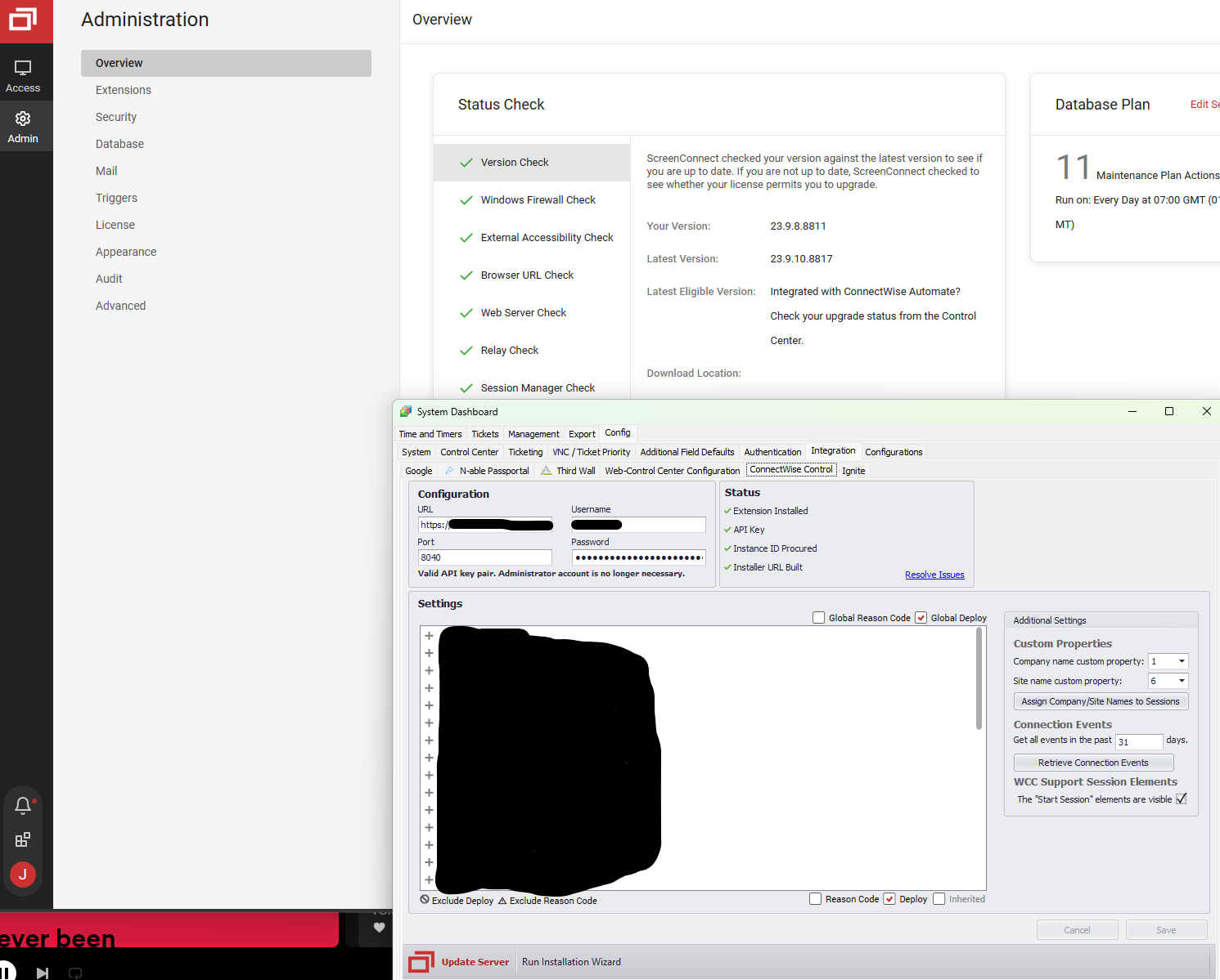

Hey Cubert, we're still getting the old behavior in Habitat 1.0.1.42. I believe our SC connection is solid (just needs a minor update). Any tips or logs we can look at?
Screenshot 2024-03-19 100130.png (157.18 KiB) Viewed 69139 times
Screenshot 2024-03-19 100015.png (57.87 KiB) Viewed 69139 times
Re: Habitat Stalled Agents Tool
Posted: Tue Mar 19, 2024 6:04 pm
Do you have the RMM+ plugin installed on your ScreenConnect server as an Extention? And it is configured in plugin correctly?
I see where we show 301 agents offline and you show 299 agents offline. A 3 agent disparity
