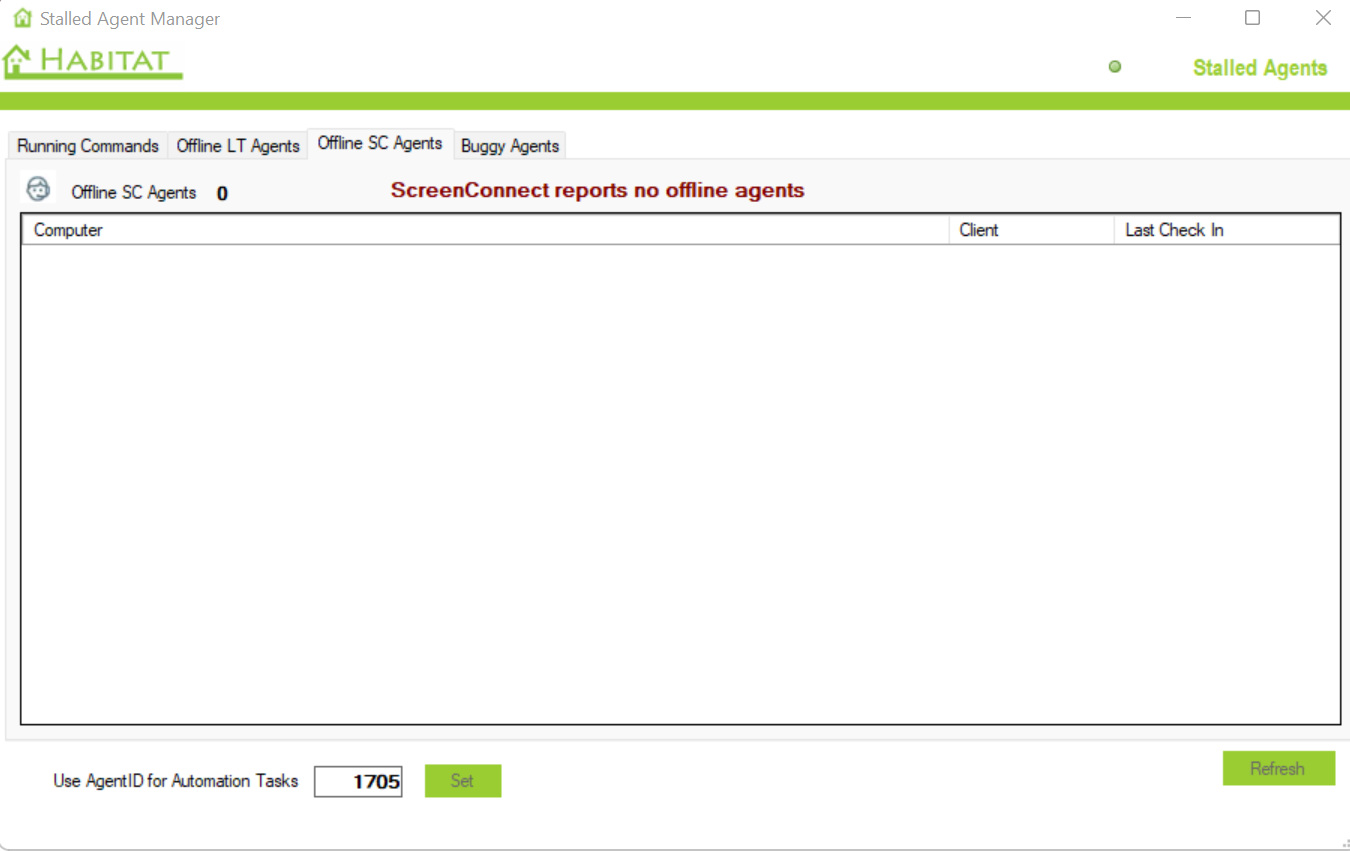

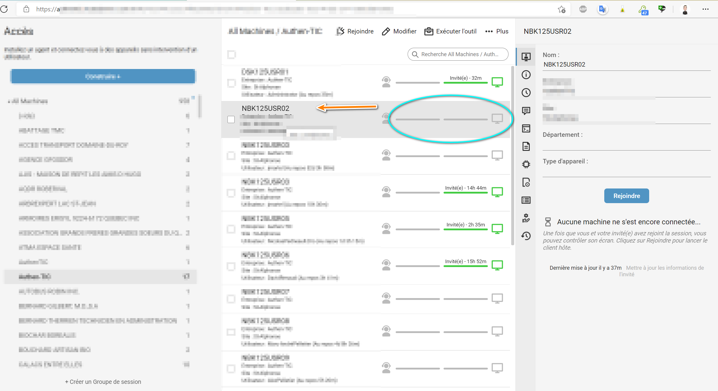

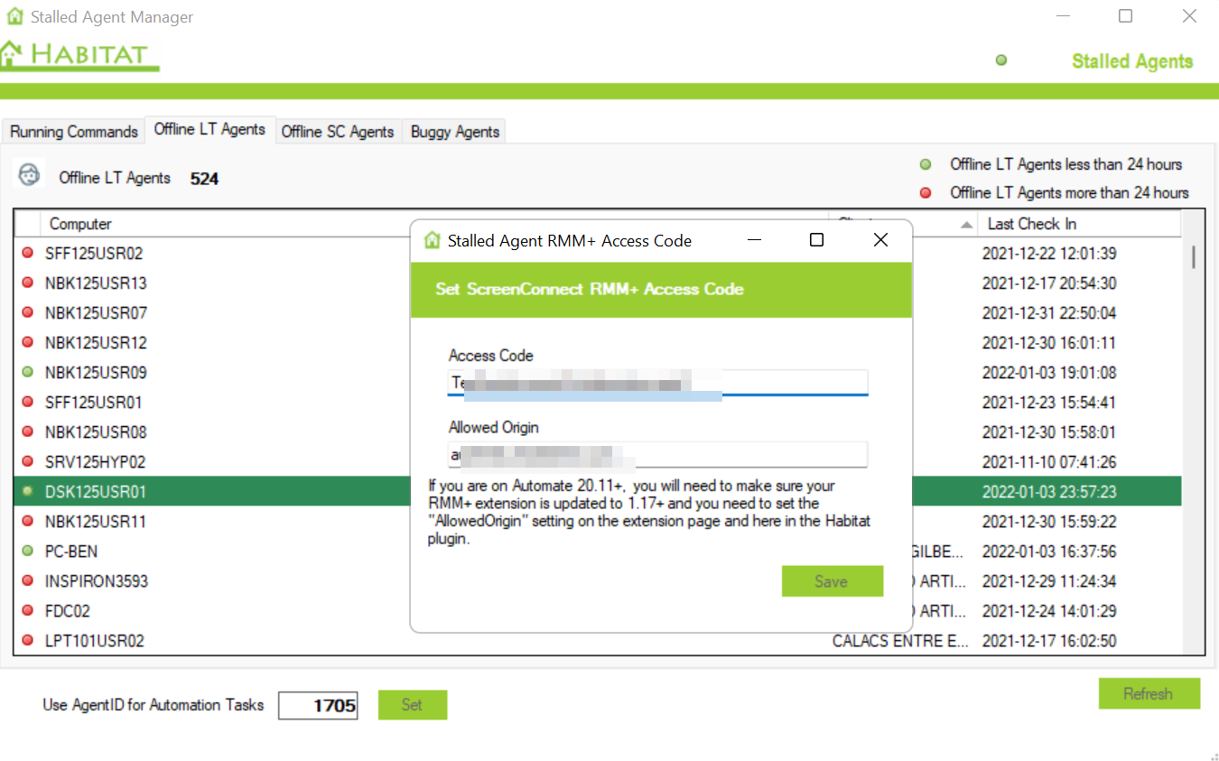

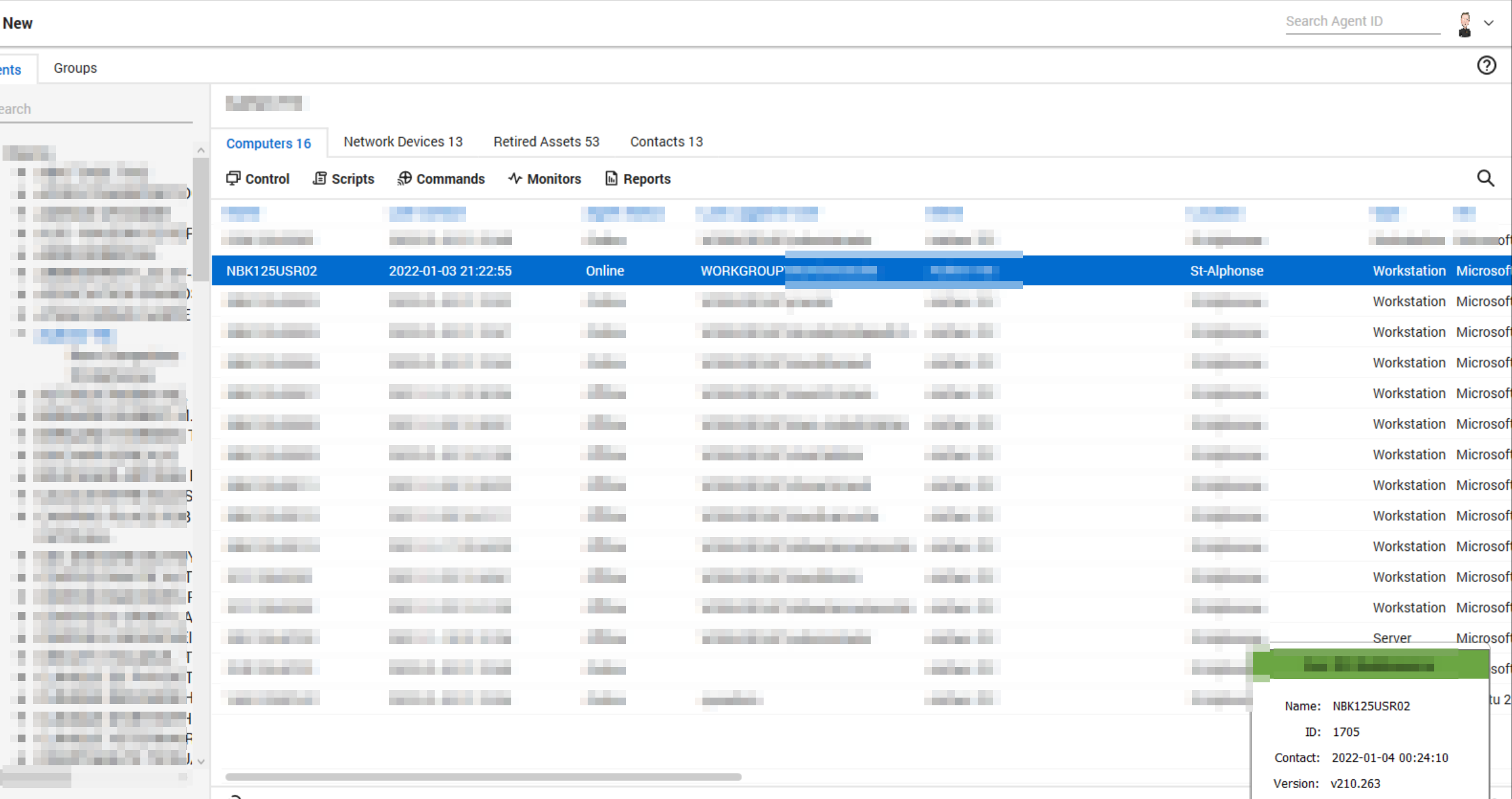

Hi, thank you for your product. I understand how tab work (if online in CWAutomate but not in CWControl etc.)
How know if the ScreenConnect tab work great?
I have a computer (my computer), this computer is Online in CWAutomate but Offline in CWControl (i have stopped services for test). You can view in my screen capture.
Why my computer do not appear in "Offline SC Agents"?
My configuration is good?
view capture, my CWA and CWC is on the same server hosted by CW)

As I went to write this response, I was going to have you walk through the different queries and executions that provide that information to the plugin to see where you maybe going south. In that process I just happened to come to a point in the code where it makes the request and I didn't see the "Origin" header in the request.
We hell that's not right! So it appears you may have found a bug. I am fixing that now and will make sure its part of 1.0.1.15 which is due out tomorrow.
Thank you for the detailed description and screenshots, it makes sure we zero in on the issues much faster. Bravo!

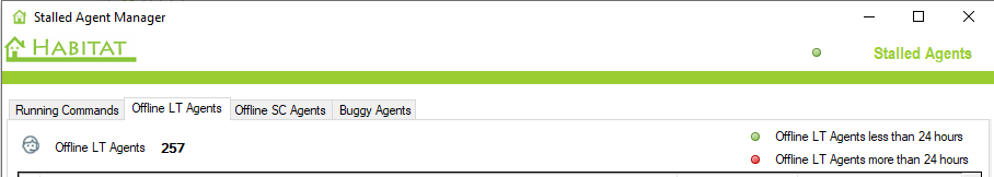

The "Offline Computers" dataview shows 253 offline computers.
The Stalled Agent Manager shows 257 "Offline" LT Agents. Since these are very similar numbers, I am let to believe they are very similar lists, perhaps with the Stalled Agent Manager being more up to date as the dataview is relying on the built-in inventory polling.
However, according to your post it seems that the Stalled Agent Manager should only be showing machines that are ONLINE in Screenconnect despite being offline in Labtech. Thus indicating a problem with the agent, as opposed to the computer simply being offline.
Thank you for your response!

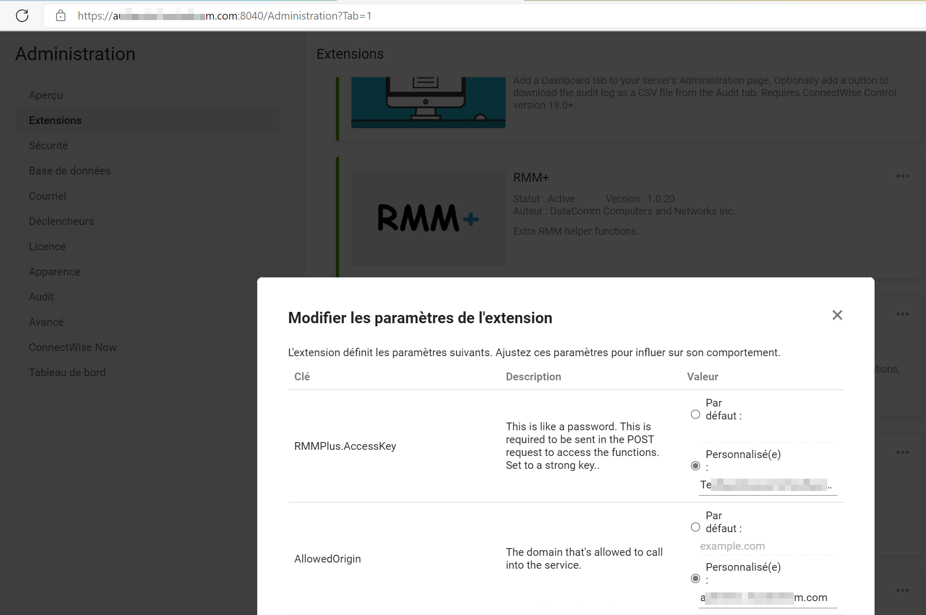

Do you have the RMM+ plugin installed on your ScreenConnect server as an Extention? And it is configured in plugin correctly?
I see where we show 301 agents offline and you show 299 agents offline. A 3 agent disparity
