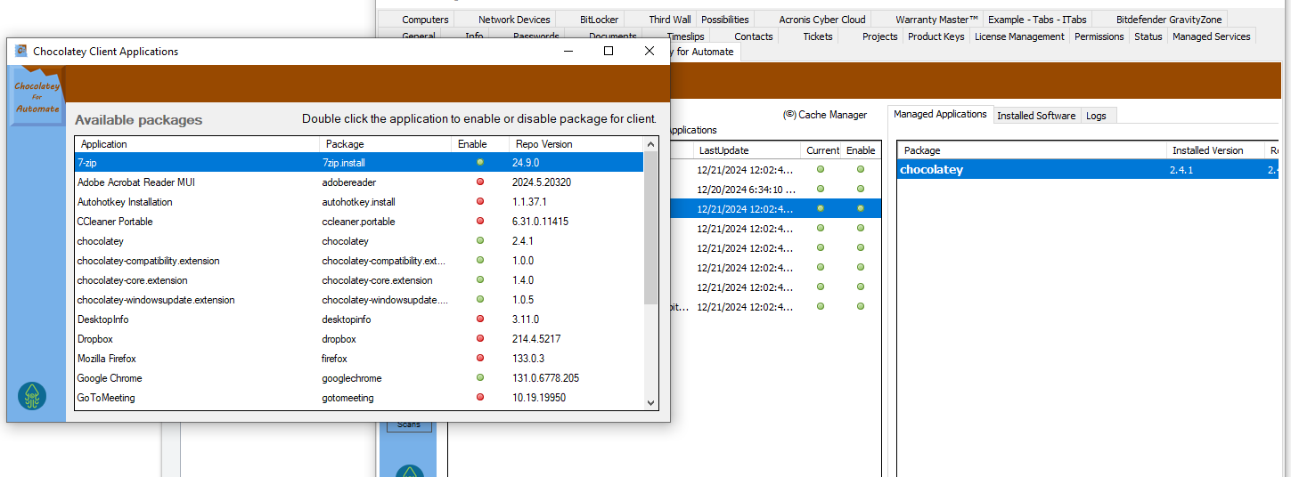

Its the next day... the machines are showing that they are up to date... some have a few or one approved app (chocolatey), but several are approved... what's going on here? Am I going to have to set the EDF manually?
Approved apps not installing
approved apps.png (67.61 KiB) Viewed 20561 times

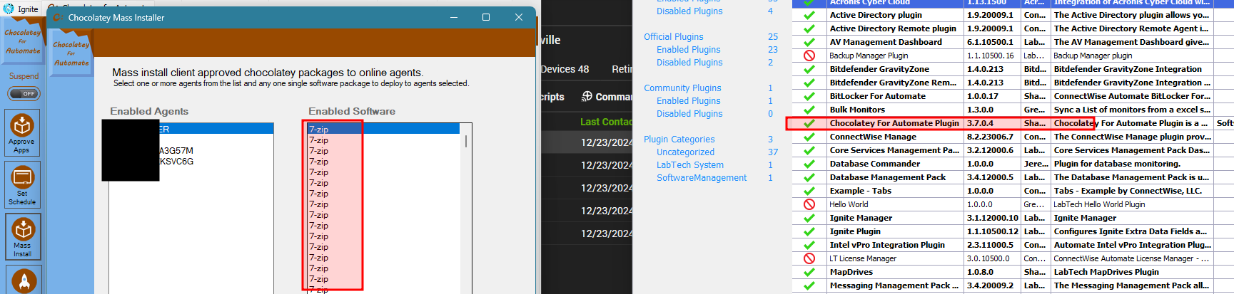

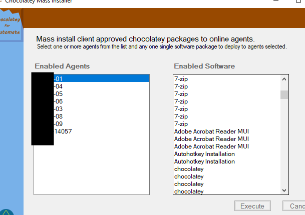

And how do we fix the multiple apps?
Multiple apps on all clients

PL-MSTech wrote: Sat Dec 21, 2024 5:57 pm And how do we fix the multiple apps?
I have found and resolved this issue in 3.7.0.5. The clientID was not being passed to the query accuratly, The field would fill up with each clients approved packages instead of just the client being managed.
This has been corrected.

Updated, reloaded remote agent plugins, restarted IIS, restarted Automate as admin... still an issue...
Mass Install Applications still duplicated in 3.7.0.4

Fixed issue with Client installer pulling packages from all clients to populate the apps list instead of just for the client under management.

PL-MSTech wrote: Mon Dec 23, 2024 7:33 pm Can you make the EDF for "Approved Applications Installed" automatically toggle off-on any time the script notices that adjustments have been made to the client approved apps? It seems that this may be commonly overlooked, especially if adding apps globally.
Plus, with several plugins and many clients, it takes some time to open each and every one to toggle that setting off then on again.
I was hoping that the Bitdefender exception would be the golden ticket to make everything work, but no such luck... maybe the manual toggle of the above mentioned field, along with your update will help.
Sure can, I will add that in on build 3.7.0.6 > Any time a positive change takes place with the client Approved Apps list, If, Auto Install Applications is checked for the client, I will reset all agents Approved Applications Installed EDF to zero. This will casue all agents under client to rejoin the Auto Install group and will redeploy any missing approved application.
