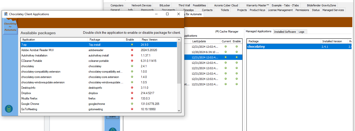

Its the next day... the machines are showing that they are up to date... some have a few or one approved app (chocolatey), but several are approved... what's going on here? Am I going to have to set the EDF manually?

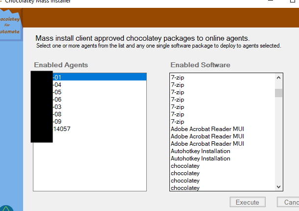

And how do we fix the multiple apps?
Multiple apps on all clients
Re: C4A groups no populating
PL-MSTech wrote: Sat Dec 21, 2024 5:57 pm And how do we fix the multiple apps?
I have found and resolved this issue in 3.7.0.5. The clientID was not being passed to the query accuratly, The field would fill up with each clients approved packages instead of just the client being managed.
This has been corrected.
You system should update tonight.

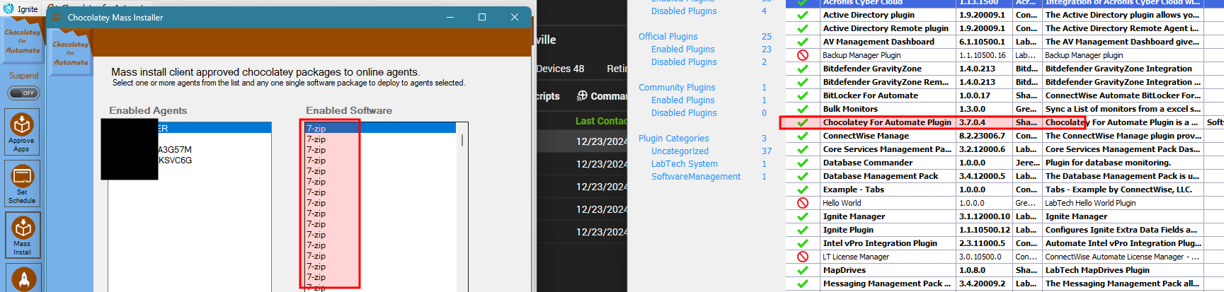

Updated, reloaded remote agent plugins, restarted IIS, restarted Automate as admin... still an issue...
Mass Install Applications still duplicated in 3.7.0.4
Yes, Its not til 3.7.0.5,
https://delivery.shopifyapps.com/-/4c9a ... 0f71398b76
ReadMe.txt ->
---3.7.0.4---
Added a lot of logging to agent actions that will show up in agent logs.
Update the Global installer function to approve the package provide in the client approve list.
Improved the Update function to speed up processing and added logging to agent logs.
---3.7.0.5---
Fixed issue with Client installer pulling packages from all clients to populate the apps list instead of just for the client under management.
