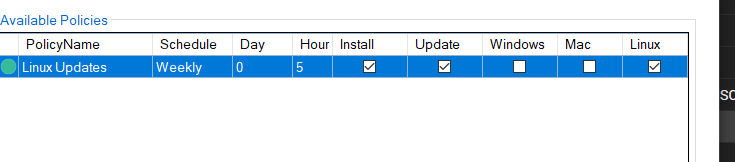

Ok packages appear to have installed without issue, did a restart, and in server logs the server is listed as being under policy.
had it rescan and has now been dropped from the list of agents that need updates installed, so I think we are good.

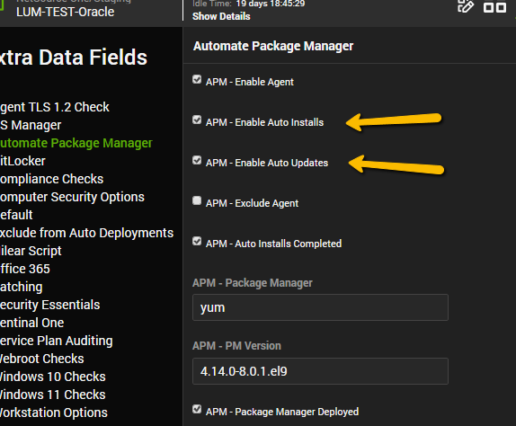

is there anything else you need from me any logs or anything, on why its not seeing the auto update enabled?
it is set to auto update in the edf and the policy thats applied to it has updates checked so not sure why that is

ok then our Test system the LUM is set to auto update the other server just happens to be under the same location but has no policy applied to it thats why its listed but not set for updating

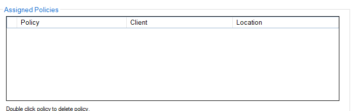

thankl you for the update, the only issue I sem to have now is the area for assigned policies doesn;t show any assigned policies even though I have polciies assigned to systems.
Re: Trying to patch a Oracle 9.3 (Linux) system it seems to find packages but they never seem to install
Assigned policies only show for locations or clients. If you apply a policy to a single agent, that agent does not show in policy list. It does however set the Policy EDF box.
Have a look at your EDFs for agent, scroll all the way to bottom to see "APM Policy". It will show the policy name assigned. If you want to drop policy, just blank out policy EDF and save.
No more policy, if agent is still set to auto update it should start updating daily.
