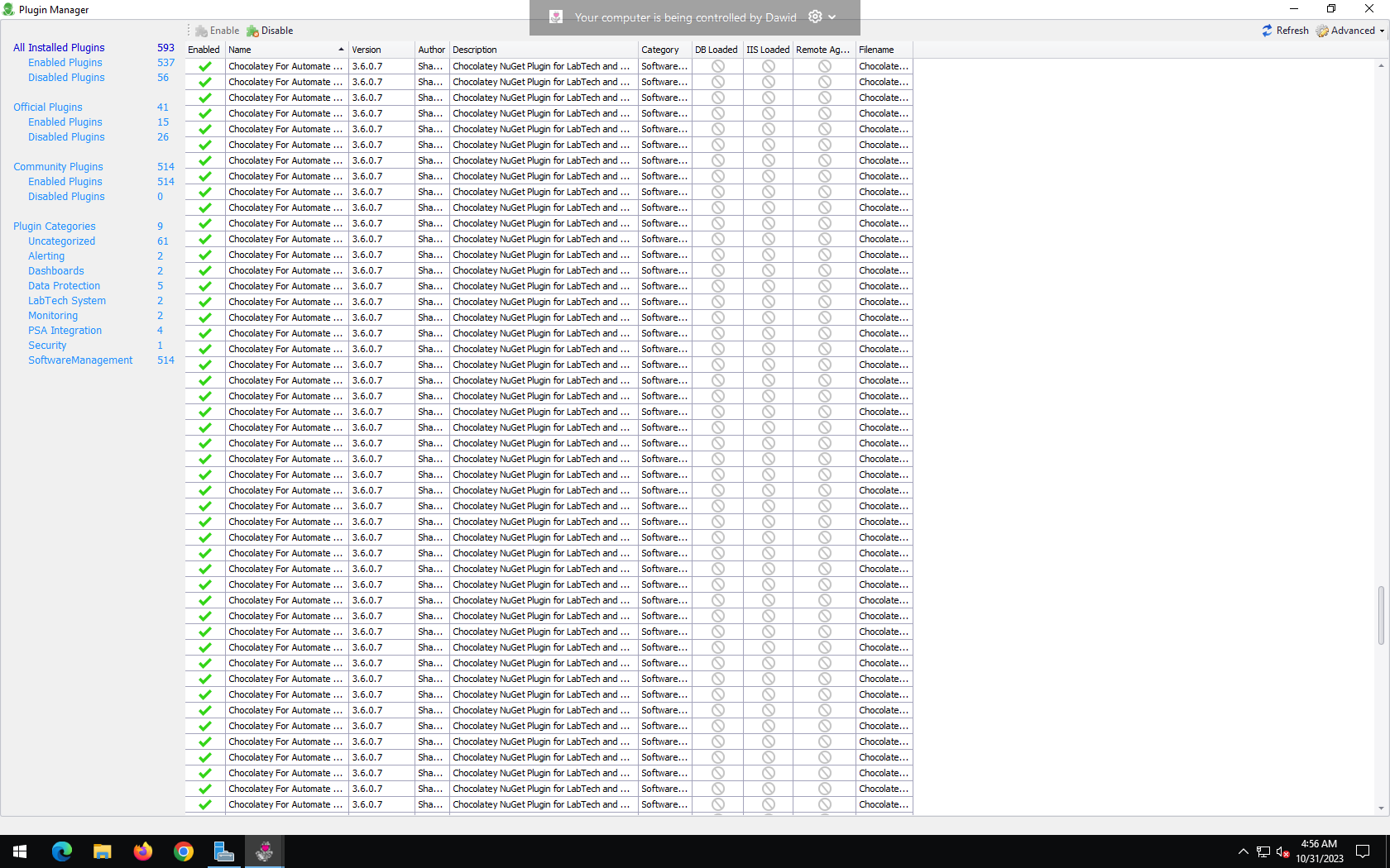

Hello,
I wasn't looking at the plugin for over a week and this happened :
ScreenConnect_Labtech Server 2022_2023-10-31_1.png (190.41 KiB) Viewed 160785 times
I am cleaning this right now and let know if something like this will happen again.
Is there a way to prevent it from automatic updates? I can do it manually because it's not like a new update every week.
